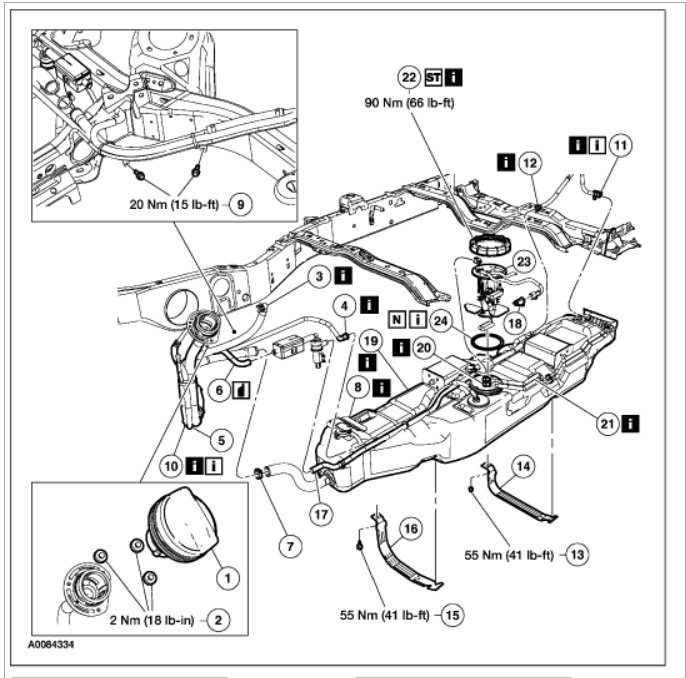

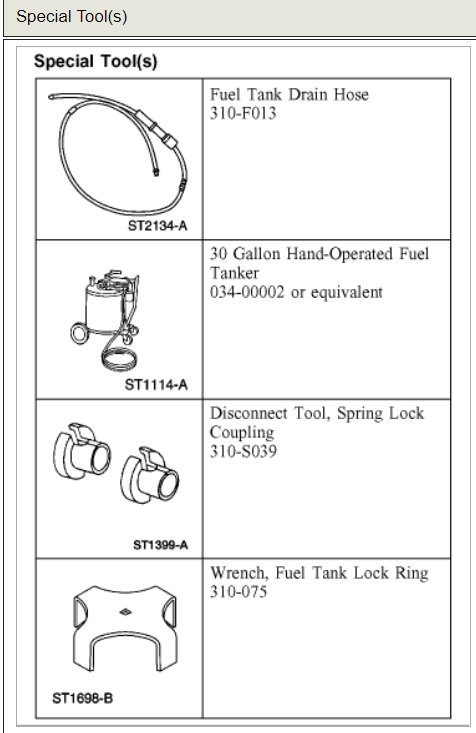

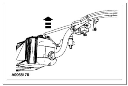

Where is the fuel level sensor located? I need to change it out.
May 21, 2010 at 9:47 PM
BLUELIGHTNIN6
  • CAR REPAIR CONTRIBUTOR
  • 16,542 POSTS

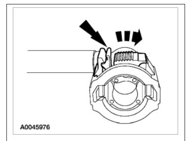

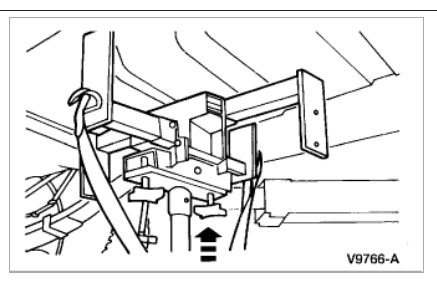

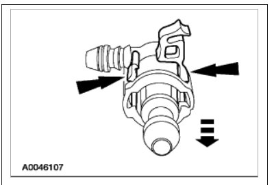

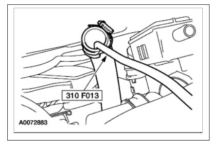

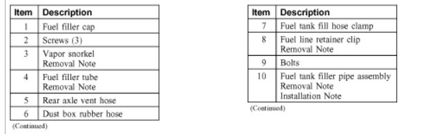

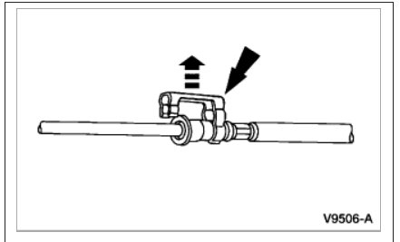

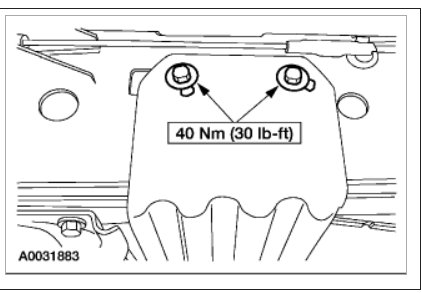

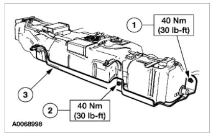

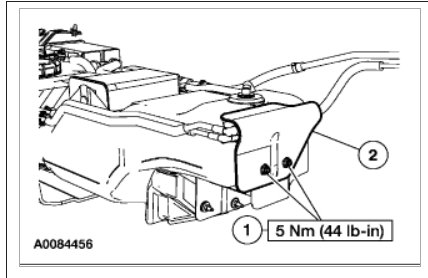

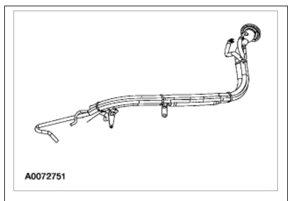

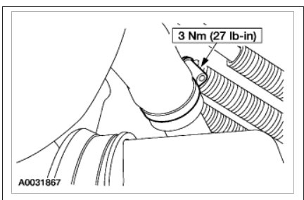

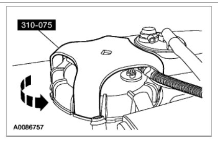

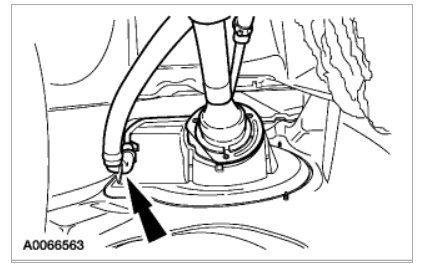

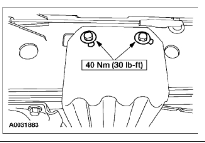

The fuel level sensor is located inside the fuel tank here are diagrams so show you what you are if for when doing the job with a generic guide that gives you the steps needed.
https://www.2carpros.com/articles/how-to-replace-an-electric-fuel-pump
you will need to remove the ford fuel lines
https://youtu.be/Boi0DPXVHbM
Here are diagrams of what it will be like for your car
