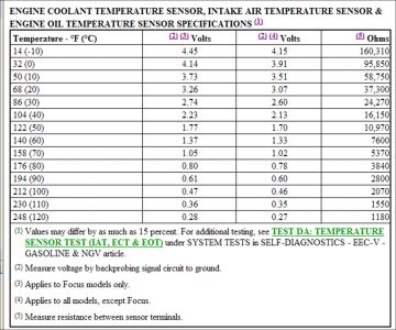

Your Engine Coolant Sensor (ECT) can also prevent this if defective.
http://www.2carpros.com/forum/automotive_pictures/248015_Picture1_52.jpg
