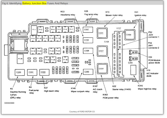

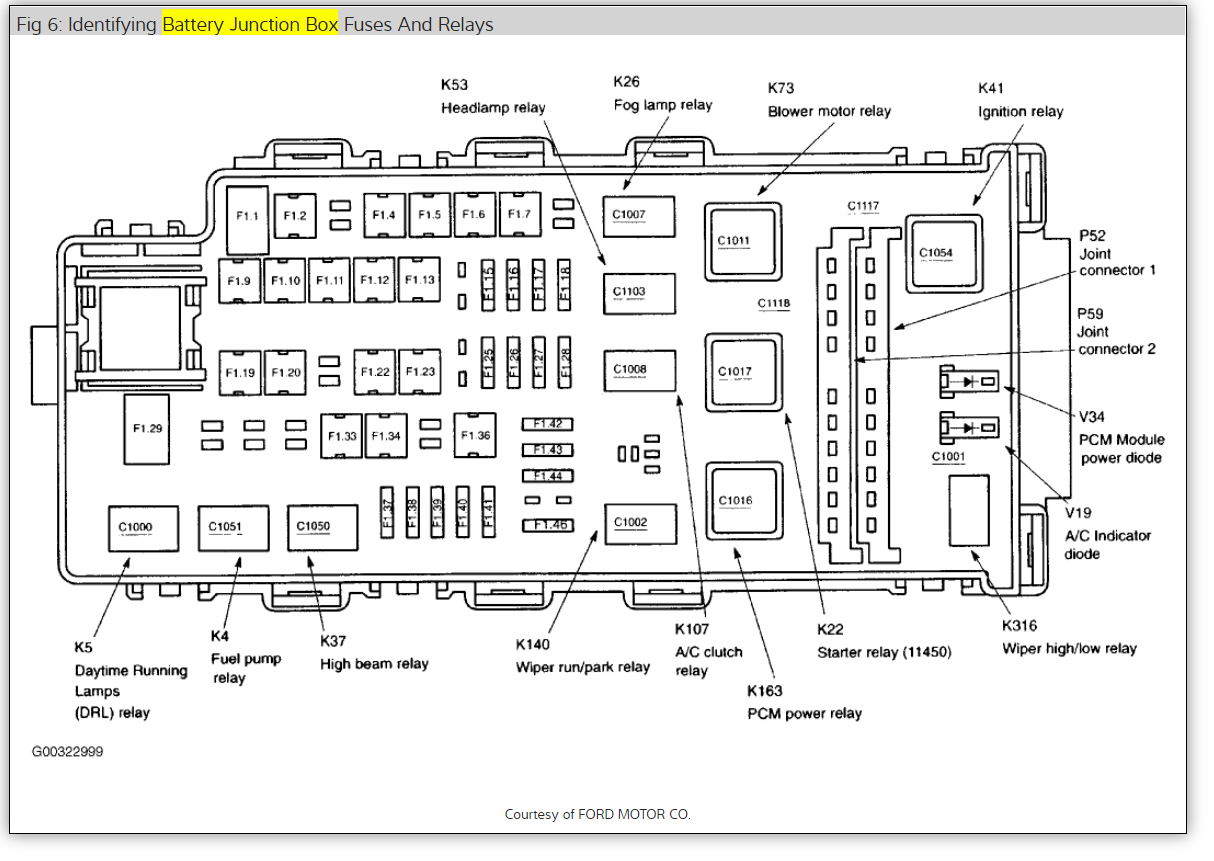

Where is the fuel pump relay?
Feb 17, 2010 at 4:10 PM
  • CAR REPAIR CONTRIBUTOR
  • 75,992 POSTS
The fuel pump relay is located under the hood. Here is a guide to help you test it and the location of the relay in the diagrams below:
Cheers
