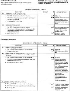

Our 1993 Ford Explorer XLT will not start. We checked the battery and it is fine so we think it might be the starter. Where is the starter located?
Friday, March 6th, 2009 AT 5:50 PM
BLUELIGHTNIN6
  • 16,542 POSTS

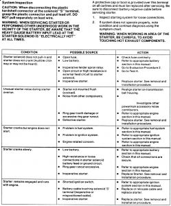

Bottom rear of engine. Follow positive battery cable to it if you have trouble locating it. Have starter tested before replacing.
https://www.2carpros.com/forum/automotive_pictures/261618_1_15.jpg
https://www.2carpros.com/forum/automotive_pictures/261618_2_15.jpg
Replacement procedures are below..
