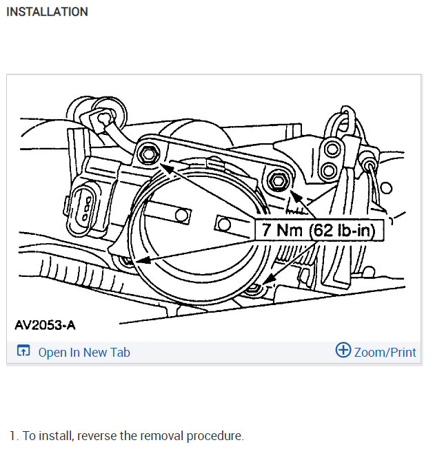

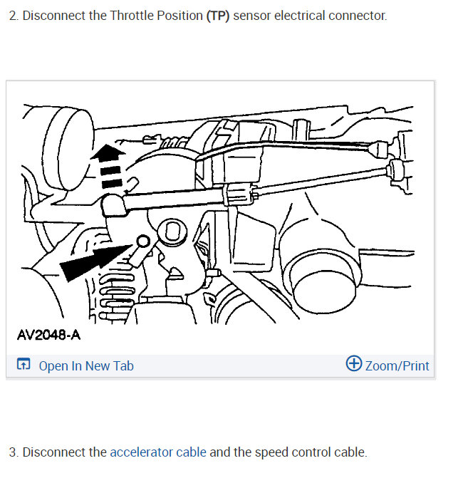

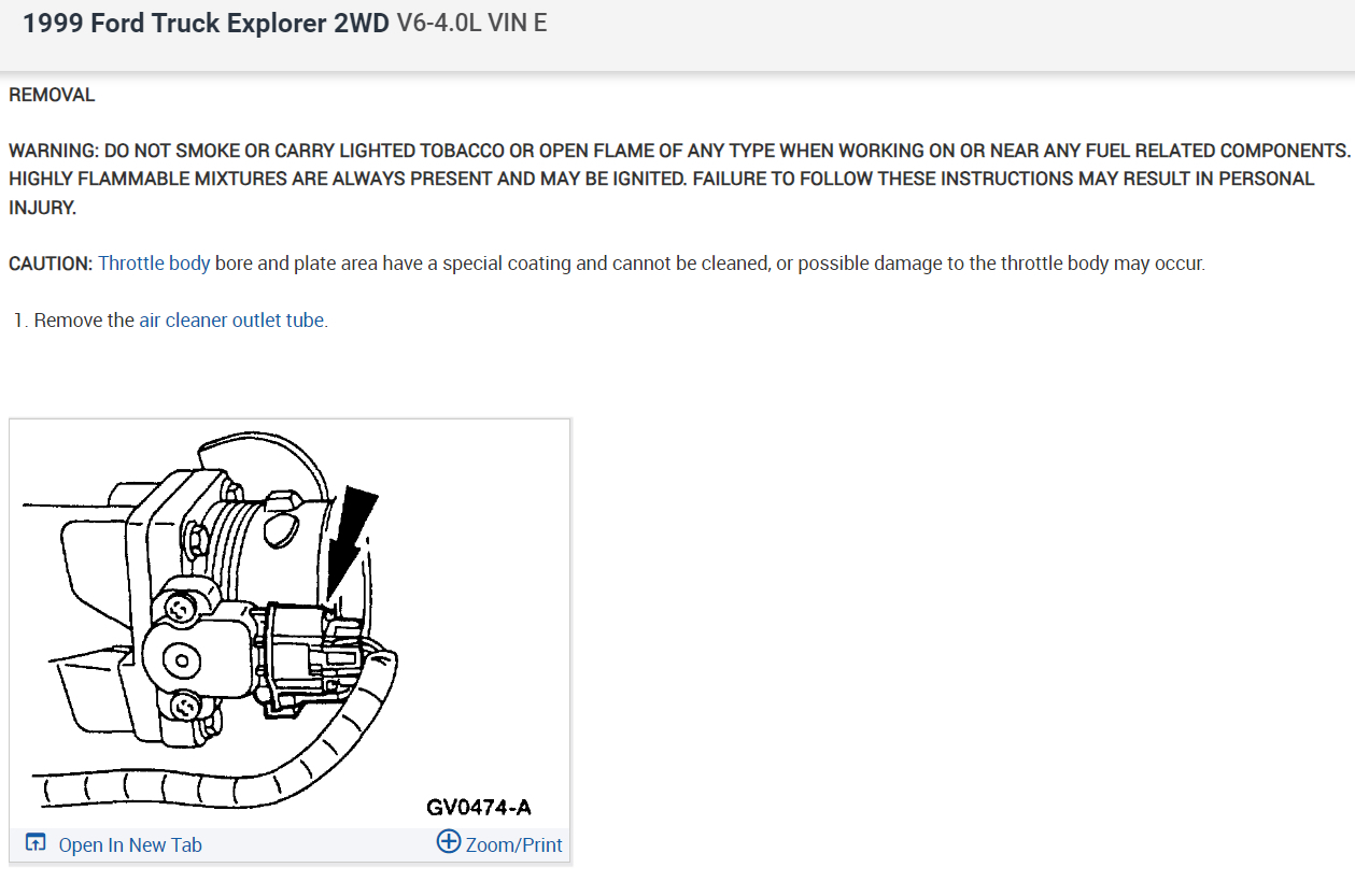

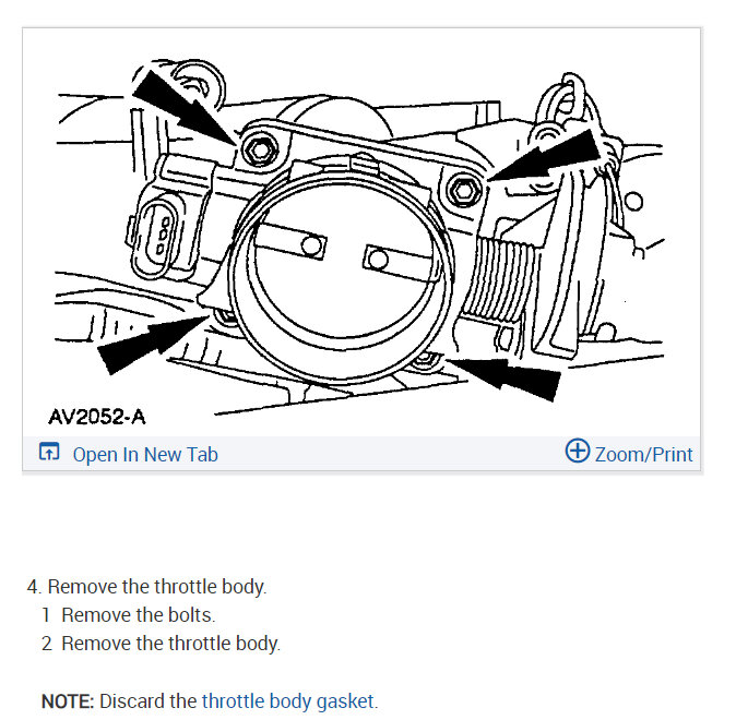

Nope, that will not help, you need to service the throttle bore, this guide will help.
Please check out the images below to see how the job is done on our car. Check out the images (below). Please let us know what happens.
