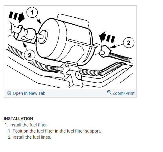

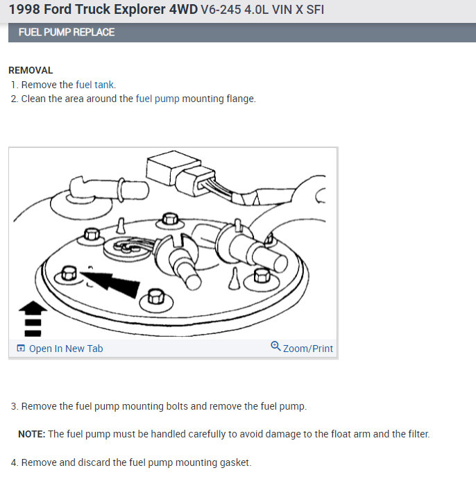

Starts but dies immediately, gas fuse or relay?

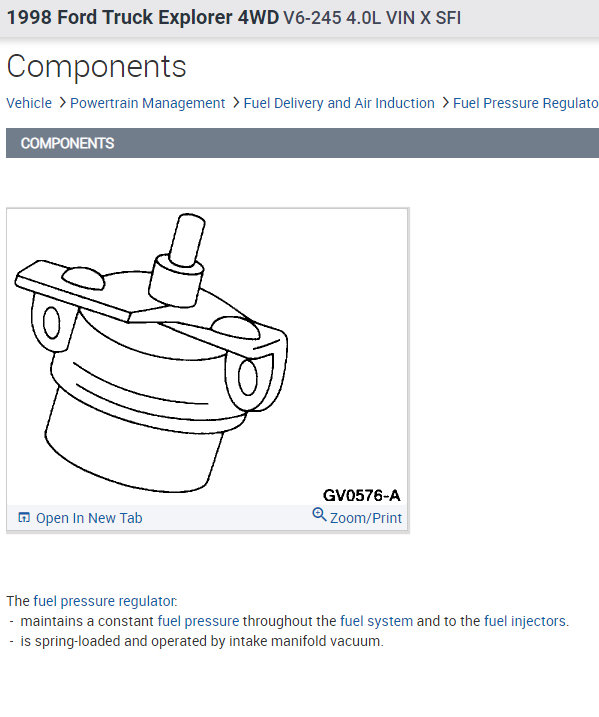

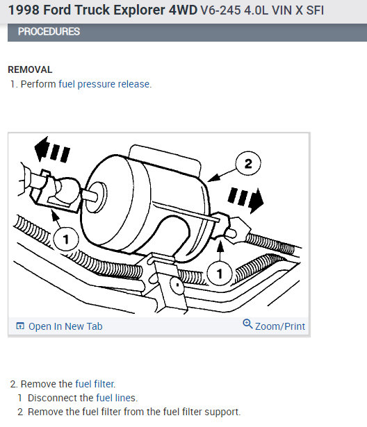

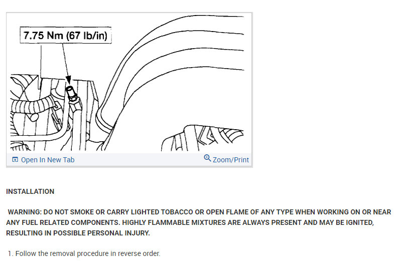

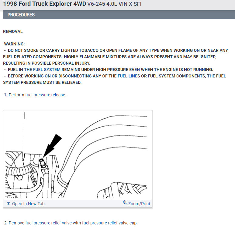

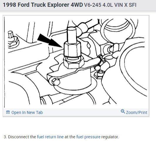

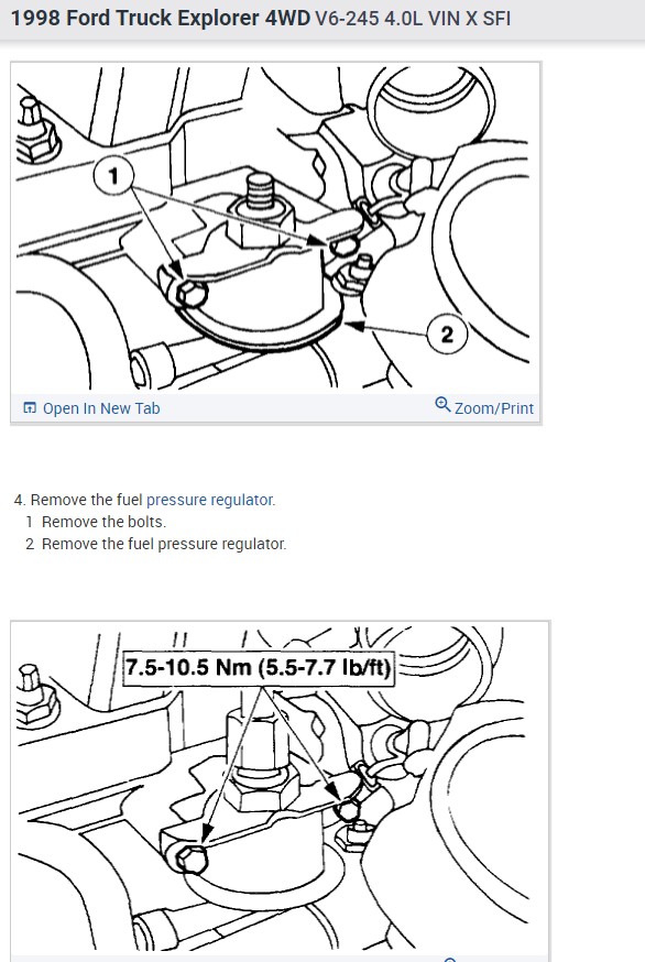

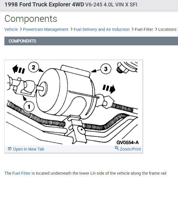

To find out the fuel issue you will have to check the fuel pressure. You could have a clogged fuel filter that is restricting fuel flow or a weak pump or faulty pressure regulator.

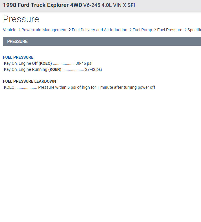

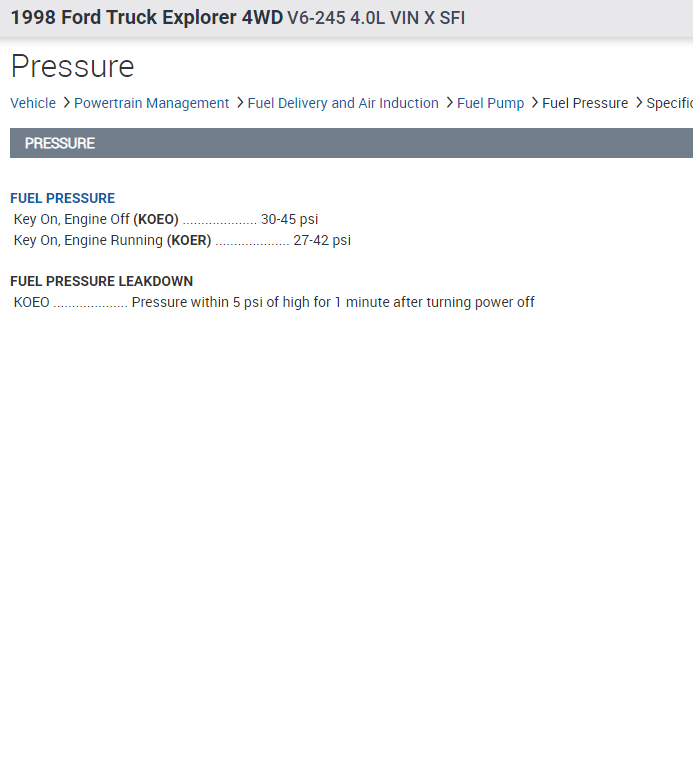

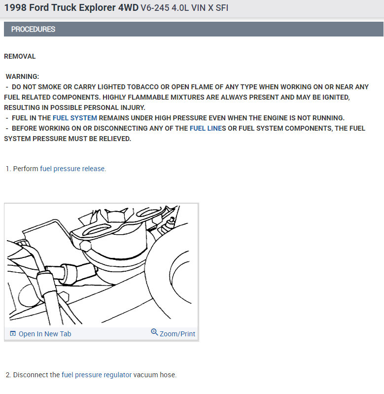

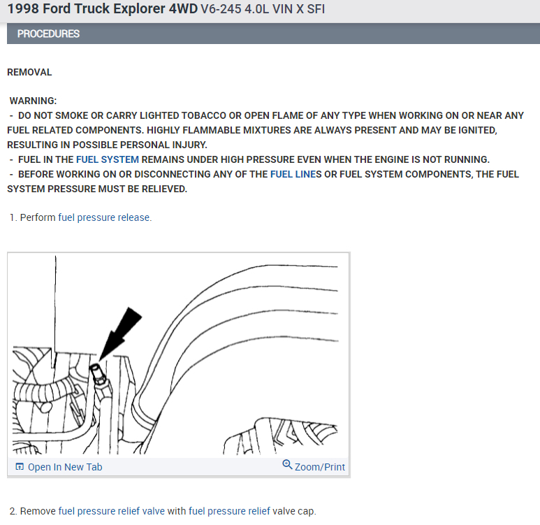

Test the fuel pressure at the fuel rail. You will need to use a fuel pressure tester, which can be borrowed from your local auto parts store.
This vehicle should have 30-45 PSI of fuel pressure with the key on and engine off.
https://youtu.be/aITQclp7zIE

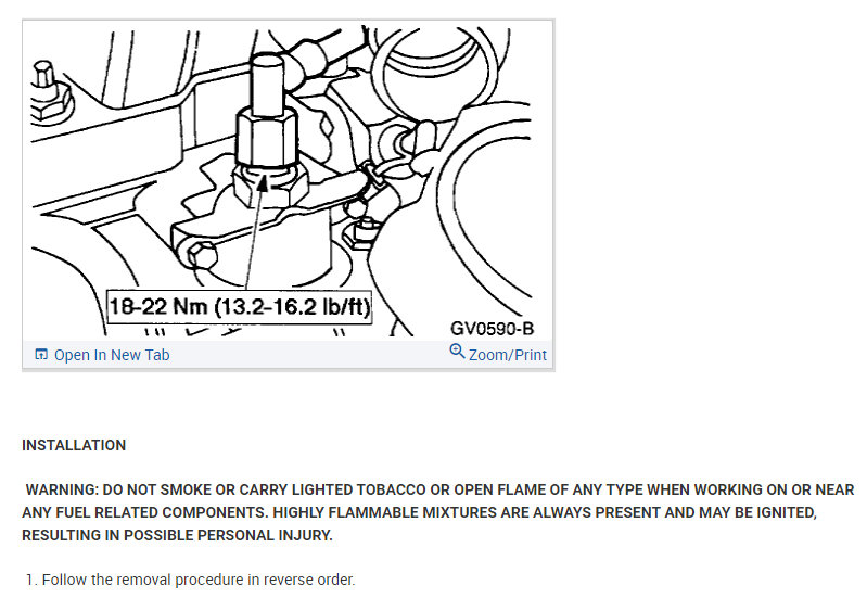

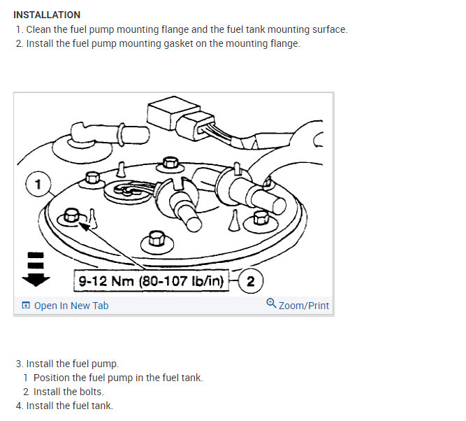

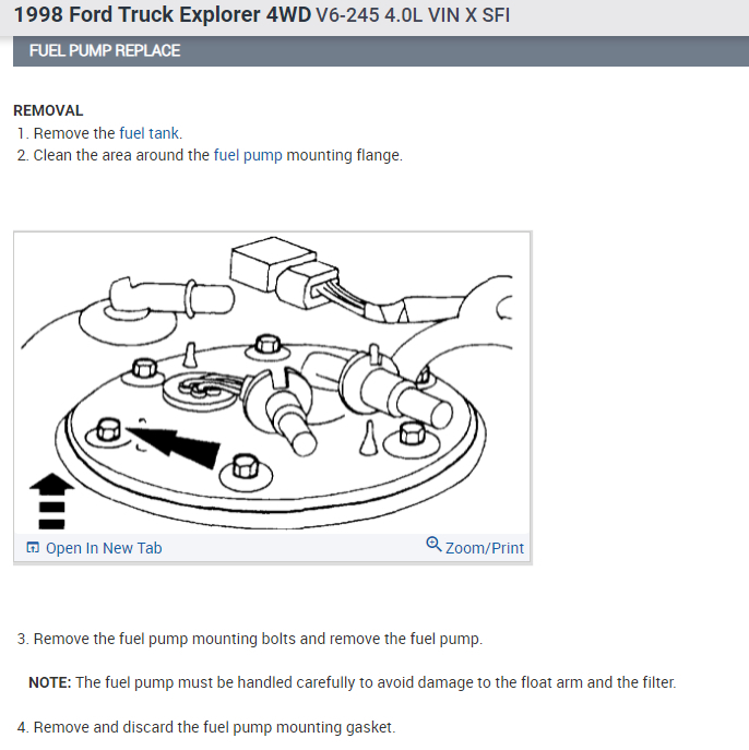

I have attached the fuel pressure test procedure as well as regulator, fuel pump and filter replacement instructions for your reference.
