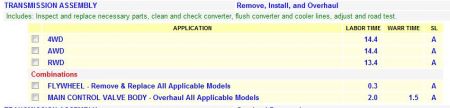

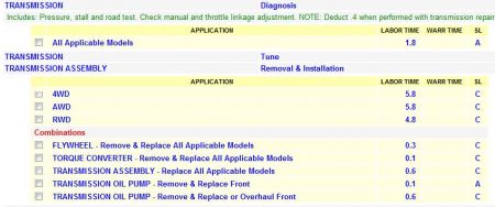

We recently had our truck towed in for transmission problems. The shop wants to charge $450 for the RDI (remove, diagnose, inspect) only and this seems high to me. I've been trying to find a labor guide online with no luck. Any opinions?

With an old truck should have them give you a price on a total rebuilt
what they given you for a price is just to rope you in
https://www.2carpros.com/forum/automotive_pictures/99387_tra_1.jpg
https://www.2carpros.com/forum/automotive_pictures/99387_traq_1.jpg
