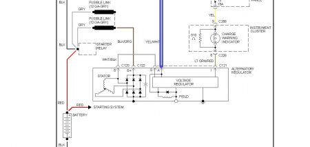

1995 Ford Explorer battery light on. Alternator tests good

Yes, the Light Grn/Red wire has 12V.
Big red wire to back of Alt has 12V.
Blk/White feedback wire reads continuity, end to end, and it is not shorted.

Since you know how to use a multimeter check all areas below in the diagram
