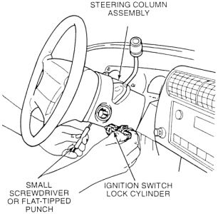

I was trying to replace it because I lost the keys. I needs to know how to get the old switch off

Assuming you meant the ignition lock cylinder (where the key inserts), the procedures are below for replacing it.
REMOVAL:
Disconnect the negative battery cable. Remove the steering wheel.
On vehicles equipped with tilt wheel, remove the tilt lever.
On vehicles equipped with tilt wheel, remove the steering column collar by pressing on the collar from the top and bottom while removing the collar.
Remove the instrument panel trim cover retaining screws. Remove the trim cover.
Remove the 2 screws from the bottom of the steering column shroud. Remove the bottom half of the shroud by pulling the shroud down and toward the rear of the vehicle.
Turn the lock cylinder with the ignition key in it to the ON position. On vehicles equipped with automatic transmission be sure that the selector lever is in the P position.
Push up on the lock cylinder retaining pin with a 1/8 in. (3mm) diameter wire pin or small punch. Pull the lock cylinder from the column housing. Disconnect the lock cylinder wiring plug from the horn brush wiring connector.
(((Push the lock cylinder retaining pin then pull the cylinder from the column)))
