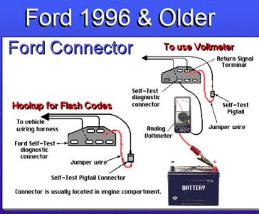

Do this and count the flashes...Count the flashes, a 22 will flash as 2 flashes then a short pause, then 2 flashes, if more than one code is stored, the pause will be longer. The codes will display three times and end with 11 or 111. Write them down and post here. First do this with the ke on engine off, then again with it running.
http://www.2carpros.com/forum/automotive_pictures/62217_Test_Connector_Pre96_25.jpg
Saturday, August 9th, 2008 AT 7:21 AM
BLACKOP555
  • 10,386 POSTS
Remember when removing the jumperwire make sure you turn off the key or youll clear the codes.
