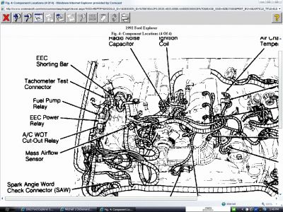

Check the computer wiring connectors for corrosion/tightness if okay test the EEC power relay this is involved with the fuel pump relay and coil to include the computer When you turn the key to the on position without cranking the engine over can you hear the fuel pump run in the tank for 5 seconds?

Ok yes I did check the computer and the connections were clean when I put the new computer in. Where is the eec power relay? There is one relay that is next to the blower motor that runs the fuel pump and it clicks when I turn the switch on. Under the the maxi fuse panel there another panel that has relays in it. Is it one of them? This is so flustrateing

Ok I have checked the connections and they seem to be ok. I checked that relay that you said and it is working its clicking when the keys turned on. I also unplugged the ignition coil pack module and checked for power and its getting power. I have changed the coil pack, crank sensor, computer inside the passenger kick panel and I have changed the little black computer box thats located in front of the battery looks to be a module. I cleaned the elctricaly plugs on the drivers side and the big one thats under the alternator. What have I missed? What is wrong

Check and test the EEC power relay and the Fuel pump relay

Ok I went out and bought a new eec relay and fuel pump relay and it still don't have fire or fuel. With regardes to the new stuff that I have all ready put on there

Hey check this out. I found out that the maxi fuse was blown for the eec power relay. I replaced it and it blew again. I used a jumper wire and the fuel came on and it ran for 10 seconds and then it burned the wire into. What would make it have a short that bad that it would burn the jumper wire? I have traced them and can't see anything physical that would cause it to short out. With regards to the new things that I put on it

Under the hood find the power distribution center, onRight fender well, in there you will find the fuel pump relay, it needs to be replaced, or the regulator on the fuel rail...To figure that out, you need to pressure test the sysem...
https://www.2carpros.com/forum/automotive_pictures/62217_FPR_1.jpg
