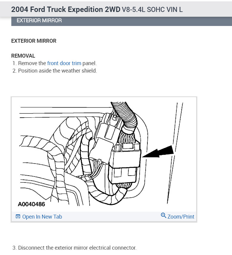

How do I replace the side mirror on the passenger side of my 2004 Ford Expedition Eddie Bauer edition?
It has remote adjust, heated and turn signal built into the mirror housing. Are there any special tools required to replace the complete housing and mirror?

Let me know if you need any of the diagrams?
Exterior Mirror
Removal and Installation
NOTE:Do not remove the exterior mirror assembly when repairing an individual part. Individual components can be installed without removing the exterior mirror.
Remove the front door trim panel. For additional information, refer to INTERIOR TRIM AND ORNAMENTATION.
Position aside the weather shield.
Disconnect the exterior mirror electrical connector.
Fig. 38: Disconnecting Exterior Mirror Electrical Connector
Courtesy of FORD MOTOR CO.

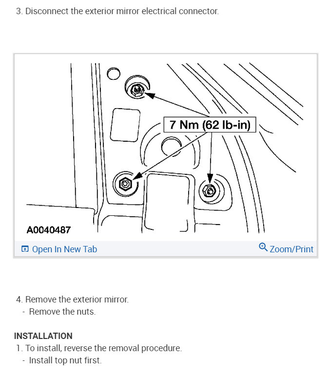

Remove the exterior mirror.
Remove the nuts.
Fig. 39: Removing Exterior Mirror
To install, reverse the removal procedure.
Install top nut first.

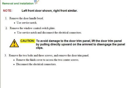

Need instruction on removing inside driver side door panel in order to replace drivers side mirror

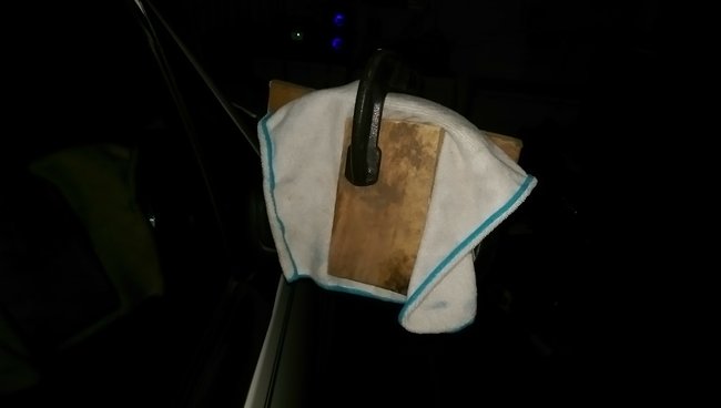

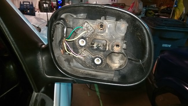

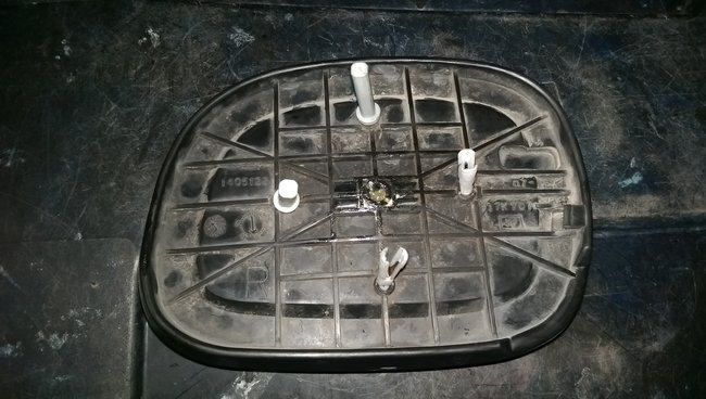

I removed mirror glass head to install arrow light indicators. Do I have to brake out glass to have more leverage to push back glass surface with groove onto ball? Very hard to ball back groove.
Tuesday, July 21st, 2020 AT 1:57 PM (Merged)
KEN L
  • MASTER CERTIFIED MECHANIC
  • 55,322 POSTS
Yes those can be difficult to get back in. Did it fall out? You must align each one of the pegs into the holes, I don't think you should remove the glass.
ROYCAR71
  • 363 POSTS
I fix it back. I cut piece 4x4 wood about height of frame and put towel over mirror depressed gently with clamp. Later when I had to do again for other side I found I could do it with hand.
