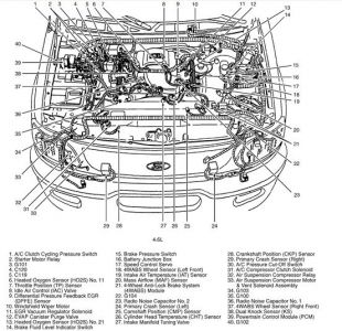

2001 Ford Expedition Four Wheel Drive Automatic 130000 miles
My "Service Engine Soon" light came on and I took it to Autozone and had the code read. It came back
p0174 - which cross checks to replacing the MAF. Where is it located in the engine and how do I replace it?

Hello Thanks for the donation Your vehicle's MAF sensor is located in the air cleaner assembly, under hood. Below is diagram of the 4.6L engine's MAF sensor location.
https://images.2carpros.com/forum/automotive_pictures/261618_Noname_461.jpg
Just remove bolts from sensor and disconnect electrical connections to replace MAF sensor. I also suggest cleaning related passageways to ensure it is free of any carbon build-up which may have been the cause of the sensor failure.. Thanks for using 2CarPRos.com!
