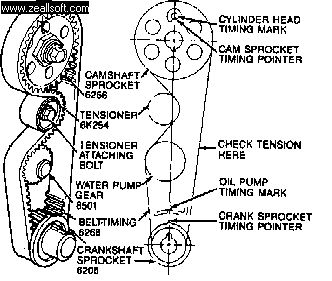

BMRFIXIT
  • 19,053 POSTS
Your compression reading very low
engine hot or cold reading very low
u said timing is there but is it correct
check the pic
https://www.2carpros.com/forum/automotive_pictures/99387_escort_2.jpg
if all good start looking foran engine
good luck

HENDRICKS433
  • 10 POSTS
How would timing just jump? Is it known for the belt to jump and timing go off?
Friday, November 16th, 2007 AT 5:20 PM
  • 75,992 POSTS
When the belt jumps it throws off the valve and igniton timing. Think! Trains
Friday, November 16th, 2007 AT 5:32 PM
HENDRICKS433
  • 10 POSTS
Well I know that but, how would it jump? Its on very tight with the groves.
Friday, November 16th, 2007 AT 5:46 PM
  • 75,992 POSTS
Things happened and over rev's of the engine. Tensioner could have gotten loose-this is the one that tensions the belt
Friday, November 16th, 2007 AT 5:49 PM
HENDRICKS433
  • 10 POSTS
I took of my cover to check timing and rotated the crank to try and line up marks but the crank turns and then the timing belt just nudges for a half a second then stops and the crank keeps turning. Any ideas?
Edit* Ok so my belts teeth are probably gone and thats the problem, but I have to take off my crank pulley to replace the belt, is there an easy way to do this without impacts?
