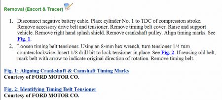

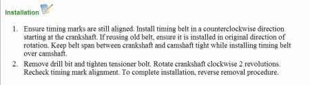

OBXAUTOMEDIC
  • 3,711 POSTS
Hi irfman2000,
billymac gave you great info and good advise.
Just thought I'd through in some Removal and Install instructions along with a couple pic's to help out.
Press your "CTRL" and the "+" key to zoom in for better reading...
https://www.2carpros.com/forum/automotive_pictures/188069_99escorttimingbeltremove_1.jpg
https://www.2carpros.com/forum/automotive_pictures/188069_99escorttimingbeltinstall_1.jpg
Fig 1
https://www.2carpros.com/forum/automotive_pictures/188069_99escorttimingmarks_1.jpg
Fig 2
https://www.2carpros.com/forum/automotive_pictures/188069_99escorttimetensioner_1.jpg

IRFMAN2000
  • 32 POSTS
Hey obxautomedic thanks for the reply but i've already read and studied the book but all I needed to know is that when I take off the belt if I can just turn the tensioner pulley with the allen wrench without loosening the bolt? That's what I keep reading up on. It never said to loosen the bolt according to the haynes manual. So I guess its not an automatic tensioner huh?
Sunday, January 25th, 2009 AT 3:33 PM
OBXAUTOMEDIC
  • 3,711 POSTS
No, you will have to loosen the tensioners.
Take a look at my post above at the remove pic.
Sunday, January 25th, 2009 AT 3:47 PM

Yea I understood the print you sent me but I keep reading that it is spring loaded. In that case why does it say to stick a drill bit or something thin to hold it back? Shouldn't stay back by itself since you gotta loosen the bolt anyway? It if doesn't stay back by itself should I mark where it was originally at then remove it? Sorry i'm just trying to get this straight here since the timing belt thing is new to me.
Oh yea on the camshaft, it does take a lot to move right? I just dont want to throw that part out of time when I slip the new belt on. Thanks again.
Sunday, January 25th, 2009 AT 3:55 PM
OBXAUTOMEDIC
  • 3,711 POSTS
Yes, it is spring loaded, No the tension when you loosen the bolt the tension goes in the direction of the belt making it tighter.
No, you don't want to mark it. With the new belt it may make it to tight or to loose. Not all belts are exactly the same size and that it why a tensioner was put there.
As far as the Cam movement, it doesn't take as much to turn it as is does for the Crank. You can move it with your hands, It gets hard once it opens a Valve. If you move it around a little (Clock Wise or Counter Clockwise) it will not hurt anything.
Also, since you will be there already are you planning on replacing the Water Pump.
Here is one thing you can do.
Before putting it all back together. You can start the vehicle just Don't Run it more than 5 -10 seconds. Do make sure your radiator hoses are connected. And have someone start it for you while you watch the timing belt because it does have a tendency to walk off since the cover is not there to keep it in place.
And to be honest they can be a pain getting back on you will just have to work it.
