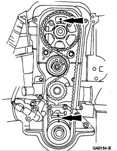

To whom it may concern:
I am having trouble with the timing belt. I lost my manual to the car so I can't even begin to intstall the timing belt. I need help with the installation or a diagram.

Align the timing marks.
https://www.2carpros.com/forum/automotive_pictures/12900_t4_6.jpg

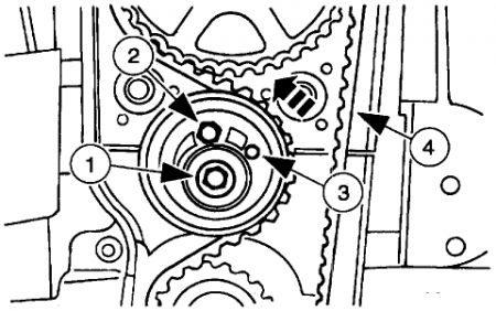

Remove the timing belt.
1 Loosen the timing belt tensioner bolt.
2 Use an 8 mm Allen wrench and turn counterclockwise.
3 Insert a 1/8 inch drill bit to lock the timing belt tensioner in place.
4 Remove the timing belt.
Inspect the belt for signs of oil contamination.

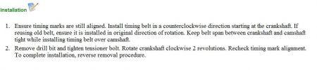

INSTALLATION
CAUTION: Incorrect removal or installation of the timing belt can result in damage to internal engine components.
https://www.2carpros.com/forum/automotive_pictures/12900_t5_5.jpg

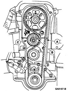

Install the (A) timing belt and remove the (B) 1/8 inch drill bit to release the (C) timing belt tensioner.
NOTE: Install the timing belt over the sprockets in a counterclockwise direction starting at the crankshaft. Keep the belt span from the crankshaft to the camshaft tight while installing the timing belt over the camshaft.

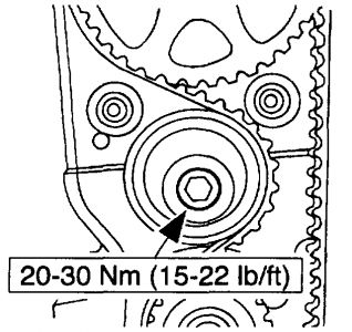

Tighten the bolt.
https://www.2carpros.com/forum/automotive_pictures/12900_t7_3.jpg
Roll the engine over two times and recheck the timing marks.
