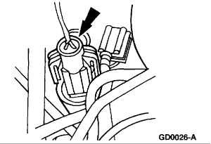

hi, my 1998 ford escort (manual transmission) speedometer, odometer have stopped working all together. I think it's the speed sensor. If it is how do I fix it and where is it located? If it's not the problem, what is?

The Vehicle Speed Sensor is located at the lower rear of the transaxle.
REMOVAL
https://www.2carpros.com/forum/automotive_pictures/12900_vss_1.gif
1.Disconnect the Vehicle Speed Sensor (VSS) electrical connector.
https://www.2carpros.com/forum/automotive_pictures/12900_vss1_1.gif
2.Remove the bolt and the VSS.
INSTALLATION
1.To install, reverse the removal procedure.
