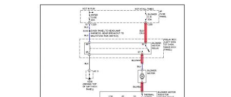

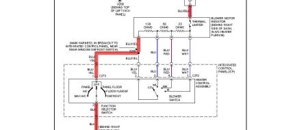

The Heater Fan does not work, I checked all of
the fuses(no luck there) I wanted to know if there
is a relay that is easily accessable to check.
Or maybe it is the blower switch?
Thursday, October 30th, 2008 AT 12:20 PM
MECHANIC
75,992 POSTS
Below is your circuit diagram go from here
