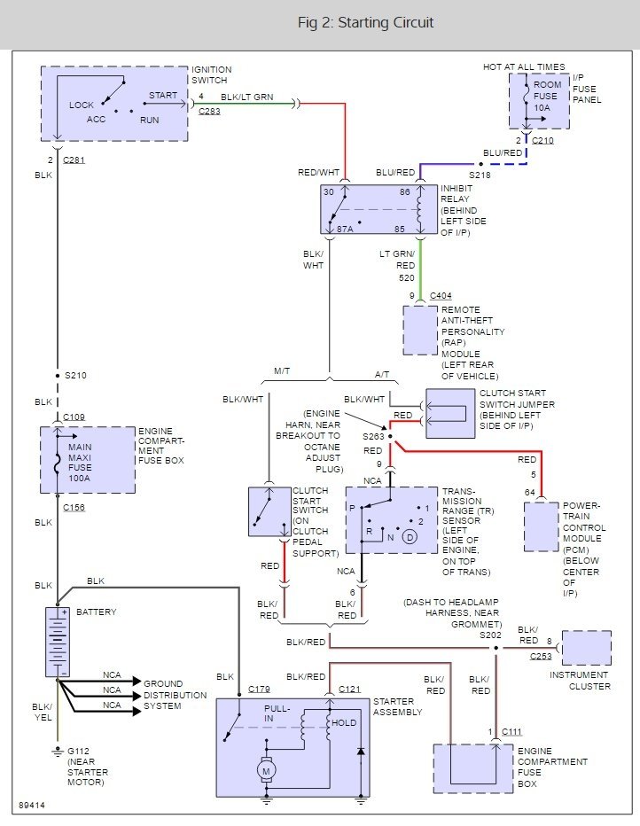

Where is starter relay located?

Hey NORM51
There is no starter relay becasue it is called a inhibitor relay. Here is a wiring diagram that shows where it is and a guide for testing it.
and
Please let us know what you find so it will help others.
Best, Ken

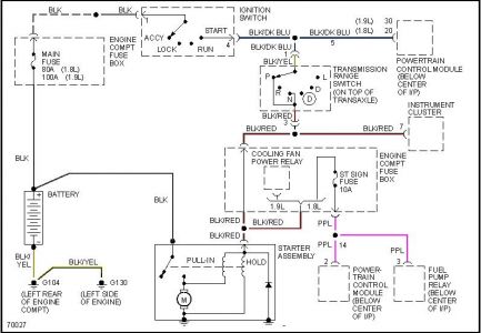

1995 Ford Escort 4 cyl Two Wheel Drive Automatic 140000 miles
where can I find the starter relay?
