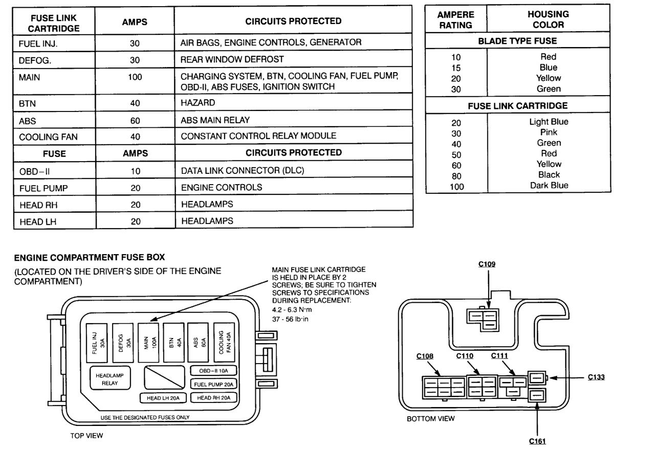

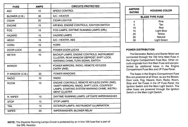

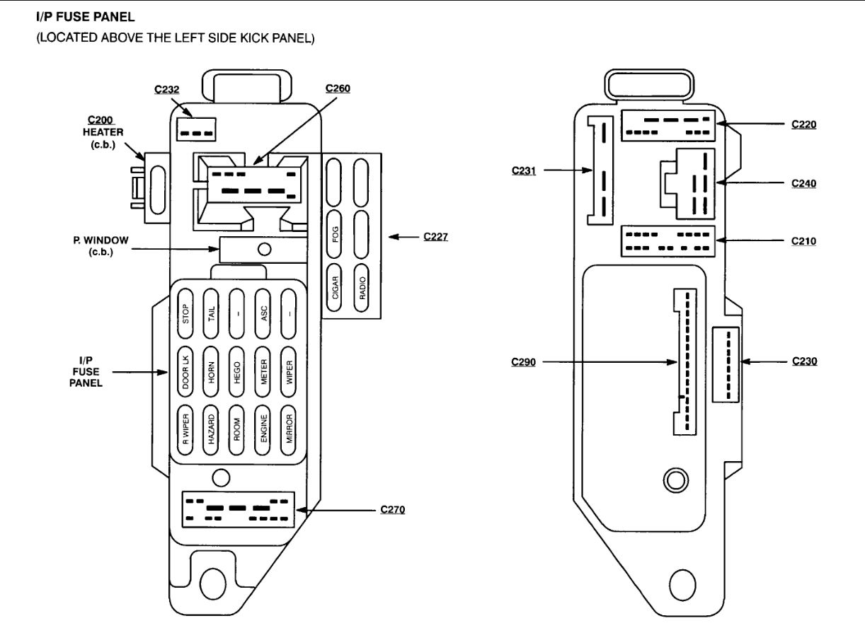

I need a diagram for the fuses please
Tuesday, April 21st, 2009 AT 4:06 PM
BLUELIGHTNIN6
  • 16,542 POSTS
This is what our manual shows for a 97 Escort, if it doesn't match you will need to get back to us with an exact production date off the sticker on the inside of the drivers door jamb
Read the guide below on using a test light, great way to check fuses
see attached diagrams below for fuse ID
