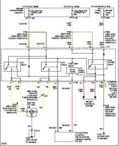

Please help, does anyone know the amperage draw for the cooling fan w/ac? Even the service dealer could not answer that one. Thank you!

10 volts what problem are you having with your fan?

Manual on/off switch for the cooling fan. (Switch overheats). Please send a diagram of a relay inline with the on /off switch for the cooling fan. Thank you!

https://www.2carpros.com/forum/automotive_pictures/261618_Noname_1000.jpg
image too small? give me your email addy and I will send it to you in better format.
