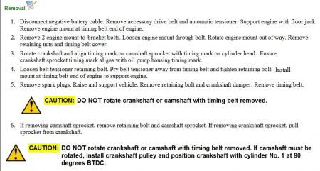

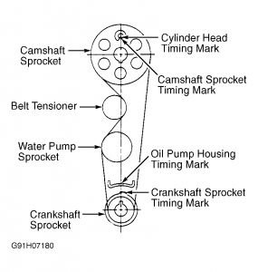

Can you please describe the process for changing the timing belt?
I need to know where to place the point on the crank and the cam shft.
Thanks,
Jim
