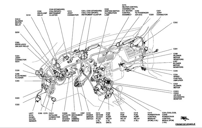

Where is the Ignition Control Module located on my vehicle. It's a 1.9 liter.
Sunday, April 5th, 2009 AT 7:07 AM
15 Replies
BMRFIXIT
  • 19,053 POSTS
The ignition control module is an internal feature of the Powertrain Control Module (PCM) and is no longer a separate component. Here is th PCM location. Check out the diagrams (Below). Please let us know if you need anything else to get the problem fixed.

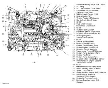

I can't find the ing. Module. My repair book says that 1996 and above have the module in the pcm. The part stores show a seperate module for this year. 1995 show it over right frnder behind the fuse box. On my car I cant find it anywhere. Where is it located?
Thanks Adam in Oklahoma!
Thursday, April 16th, 2020 AT 11:53 AM (Merged)
DAVE H
  • 13,384 POSTS
Distributor Ignition (DI) Module (1.8L)Left side of engine compartment, above wheelwell. See Fig. 1

DISTRIBUTOR IGNITION (DI)
DI system uses an ignition control module (located on left strut tower), Crankshaft Position (CKP) sensor and PCM to regulate ignition timing. Piston position and engine RPM are monitored by CKP sensor and Camshaft Position (CMP) sensor.

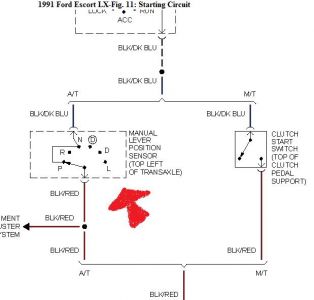

Alright my car wont start at all doesnt click doesnt turn over nothing. Tho there is power everything else works electrically tried to batteries fully charged nothing. Took out the starter(big waste of time) had it checked it was fine. I talked to someone recently who said it was probably the ballast resistor. But even if it was I cant find the ignition module was wondering if any1 thought that could be the problem, and where its located I got one of those car repair manuals for it but it only shows where the newer model escorts ignition module is located any help would be greatly appreciated
DAVE H
  • 13,384 POSTS
Have you checked the ignition switch .. a common fault on fords also check the manual lever position sensor on the transaxle !!
