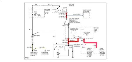

I can kick start, runs great. New starter, starter bench tested. Good batery full charged, battery connetions good, when I turn key I hear a click thats all, fuel pump kicks on. Neutral Safety Switch seems to work. No drain on lights when I turn the key. Made sure all connetion is on starter, main wire plus the one to cylinoid. Well grounded. All fuses good.

Check and test the clutch start switch,also see your Starting system EWD below
https://www.2carpros.com/forum/automotive_pictures/12900_s1_30.jpg
