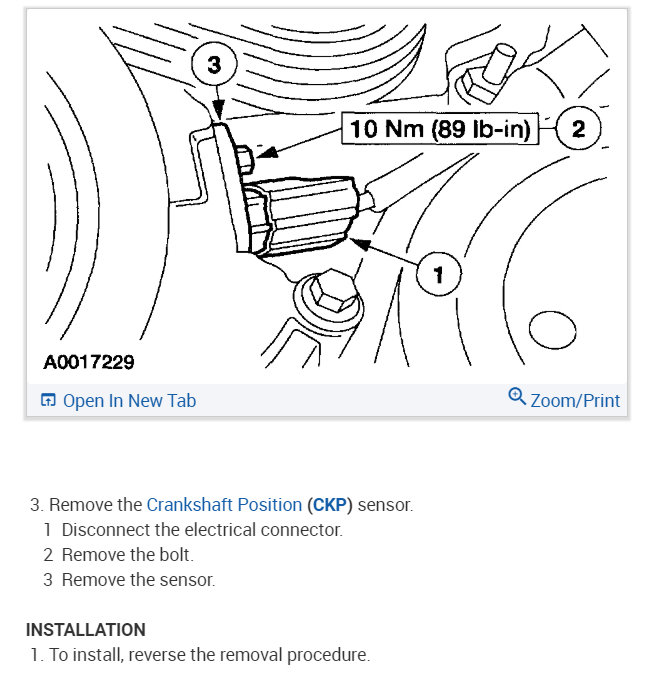

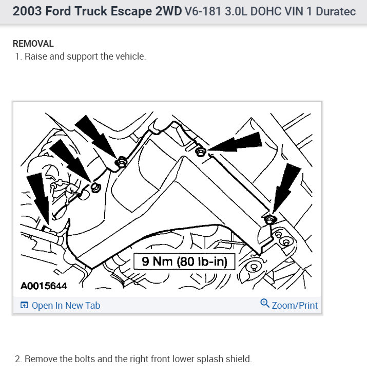

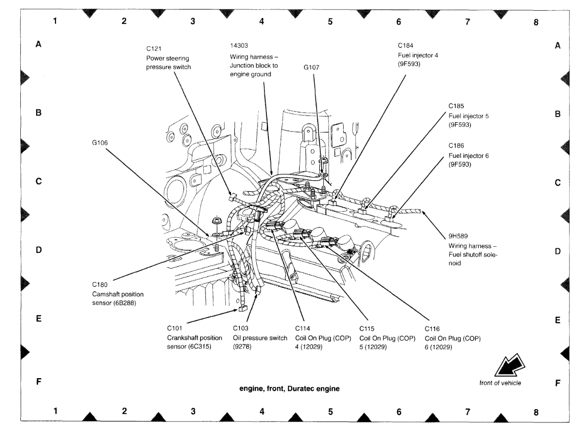

This sounds like a typical crankshaft angle sensor going out which will not trigger and trouble code. Here is a guide to walk you through the steps and the location of the sensor on your car below:

I fixed problem two days ago. It was crankshaft sensor.
