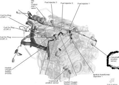

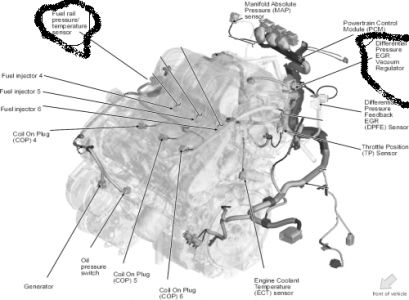

you did replace what we call the most likely causes of the problem such as such as DFPE sensor, DPEVR(differential pressure EGR vacuum regulator)
Next is to check the camshaft position sensor,it could cause similar problem.then you have a faulty catalytic as a potential candidate. Beside that you have the fuel pressure sensor as a second candidate to cause that problem.
This can help to locate the components
(check your email )
https://www.2carpros.com/forum/automotive_pictures/46384_dpevr_1.jpg
https://www.2carpros.com/forum/automotive_pictures/46384_camshaft_1.jpg

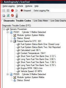

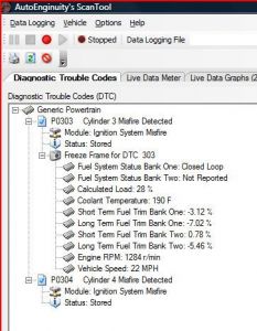

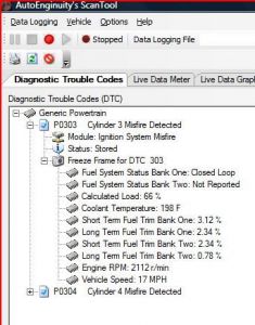

Between when I asked the first question and my follow-up I had already replaced both the fuel injectors and the fuel pump (with a used one) - believing it was a weak fuel delivery problem. The following are screen shots from several of the times that the CEL came on.
https://www.2carpros.com/forum/automotive_pictures/169479_2CP1_29DEC09_1.jpg
https://www.2carpros.com/forum/automotive_pictures/169479_2CP2_06MAR10_1.jpg
https://www.2carpros.com/forum/automotive_pictures/169479_2CP3_22MAR10_1.jpg
Hopefully they will help. I did not do the test that you suggested because the first thing that I noticed when I hooked up the scanner was the STFT was below 8 (as in the last capture). I can still try it if necessary, just let me know.

Thank you for the screen shots
have the ignition module tested at an automotive repair shop then get back to me.
