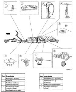

Hi where is the fuel filter located?

4.6L the F/F is located on item no.1 see below

Kk- it is drivers side bout 2-3 feet behind door, under the car - its help by a spring-like clamp - replacement price is bout 10 bucks- u will need the little ring- installer -bout 3-5 bucks I bout mine a schucks - hope this helps u - :)
