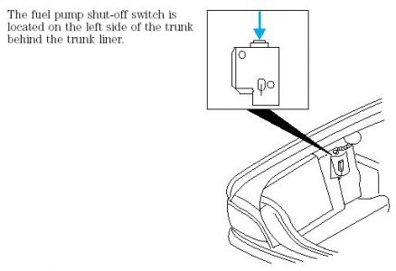

I relpaced the fuel pump and still no fuel.

Hello, did you check the inertia switch? Also, with engine cranking, check for voltage at the switch. There is also a prime connector under the hood, whatever is easy to get at.

First thing to check is the emergency shut of button in the trunk, your fuel pump relay. Have som one turn the motor on and off and listen to hear if the fuel pump makes a noise. You can listen by removing the gas cap if you can hear it come on and shut off. Than the next thing to check would be the fuel pressure put a gauge on the fuel rail and turn the key on and off a few times it should be around 35lb to 40lbs of pressure. Let me know what you have. Also make sure you have a good tight seal around the gas cap and no fuel leaks under the car. Did you replace your inline fuel filter?
