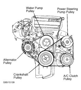

where is the water pump located?
May 7, 2019 at 10:55 AM (Merged)
BMRFIXIT
  • 19,053 POSTS
https://images.2carpros.com/forum/automotive_pictures/99387_Graphic1_170.jpg
