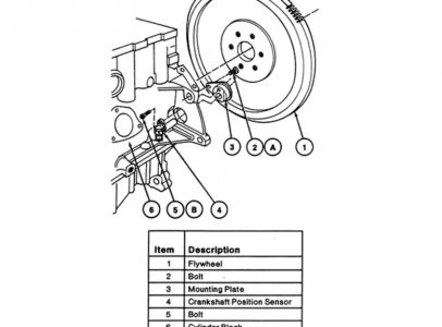

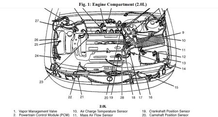

Where is the crank senor located on the 1998 Ford Contour?
Monday, November 1st, 2010 AT 11:08 AM
JDL
MECHANIC
16,098 POSTS
Sorry I don't have better picture. #19 in the diagram. 2.0Liter engine. This might be better view.
