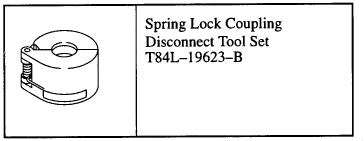

Spring Lock Coupling Disconnect Tool Set
https://www.2carpros.com/forum/automotive_pictures/12900_ec1_1.gif
SPECIAL TOOLS

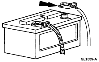

REMOVAL
https://www.2carpros.com/forum/automotive_pictures/12900_ec2_1.gif
1.Disconnect the battery ground cable.
2.Remove the heater/evaporator core housing.
