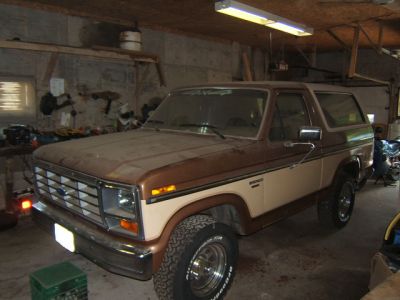

I HAVE A 1985 FULLSIZE FORD BRONCO WITH THE 351W AND 4 BRL CARB IT HAS 136,000 KM'S. THIS TRUCK HAS BEEN IT STORAGE FOR SEVERAL YEARS I PARKED WITH BRAND NEW EVERYTHING. IT FIRED RIGHT UP WITH NO HESITATION AT ALL. I TOOK IT FOR A DRIVE THEN IT WOULD JUST DIE,I WAIT FOR A BIT THEN IT WOULD START UP AGAIN IT HAPPENED A COUPLE OF TIMES. I CHECKED A FEW THINGS OUT NO SPARK CHANGED THE IGNITION MODULE STILL NO SPARK CHANGED THE COIL STILL NO SPARK NEXT IS THE PICK UP COIL I GUESS IF ANY HAS HAD THE SAME PROBLEM AND HAS FIXED IT LET ME KNOW.
http://www.2carpros.com/forum/automotive_pictures/99778_Picture_373_1.jpg

Did you check for power at the coil postive terminal while key is in On position? If power is there-Check the primary and secondary resistances on the coil-okay there, disconnect the 4-wire connector on the distributor, check resistance of the pick-up coil wires orange and purple should read 400-1300 ohms make sure your on the right scale on the meter. Make sure ICM is grounded properly.
Double check all wiring connections. Note: before you do above check for spark coming out of the coil wire if there's spark-the problem is the rotor and cap it has to make out of there to get to the plugs.
