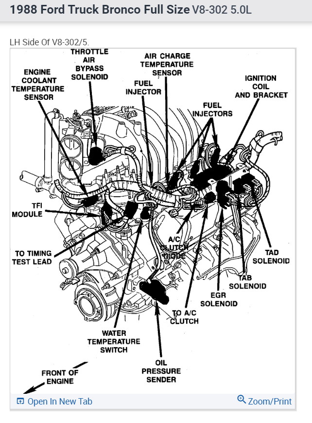

It sounds like the fuel pump is okay, it sounds like the engine coolant sensor needs to be replaced but we should run the codes to see what comes up.
This guide can help:
https://www.2carpros.com/articles/ford-lincoln-mercury-obd1-1995-and-earlier-diagnostic-trouble-code-definition-and-retrieval
This guide may help as well:
https://www.2carpros.com/articles/engine-cranks-excessively-before-starting

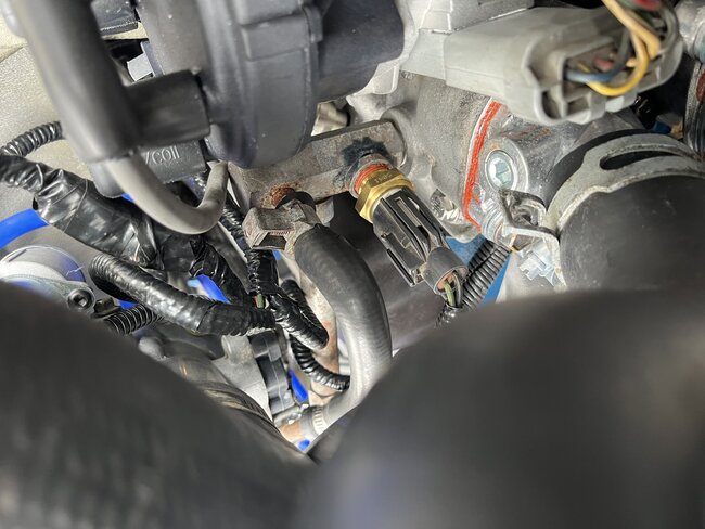

Here is the location of the engine coolant sensor so you can change it out if needed. Check out the images (below). Please let us know what happens.
Tuesday, May 2nd, 2023 AT 9:36 AM
TANG_J
  • 14 POSTS
Surely it could not be this, I’ve had this replaced as well. I will try jumping the obd1 and see if I get a code.

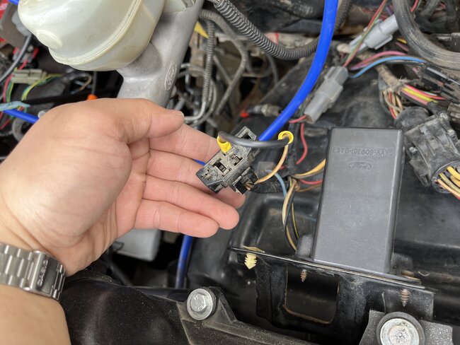

I must be doing something wrong.
I made a pigtail to the tester and the check engine light just flashed twice extremely fast. I sat there for a couple minutes while it was plugged in but nothing else flashed. I disconnected the pigtail and the turned key to the on position and there was a constant check engine light which has me ruling out that my light is bad. Nevertheless, I am going to try and replace the map sensor. I doubt it would do anything, but I will report back tomorrow.

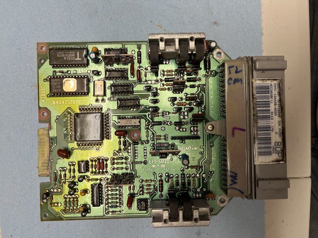

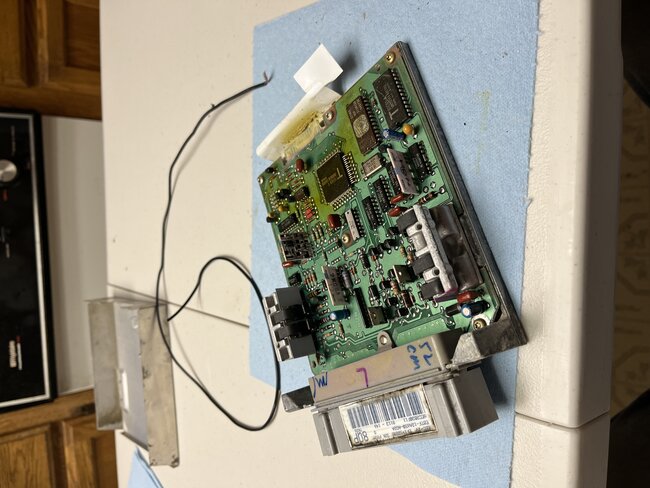

I will get a video of this when I’m back at the shop. I did take the ECM out thinking the capacitors were bad. One was but the other two were fine. The board had some discoloration around the resistors.
I had a buddy help me out trying to trouble shoot the problem and we shot some brake cleaner in, and it started right up.

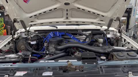

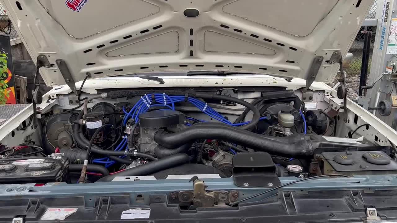

Here is a video I took with a buddy.
I’m going to try and replace the ICM that is mounted on the distributor, the distributor I bought from summit was a kit, but the ratings weren’t the best. If that doesn’t work, I have another buddy that can order a new PCM from a pick n pull.

Yep, it really looks like it is starving for fuel, if it starts well on starting fluid I would revisit the fuel pump, also does it have a new fuel filter? Thanks for the video, it helps.

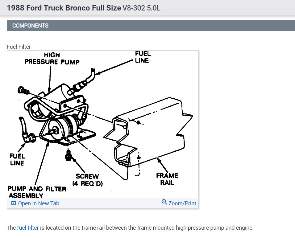

It looks like there is a fuel filter in the high-pressure pump. Have you changed the filter out? Check out the images (below). Please let us know what happens.
Monday, May 8th, 2023 AT 5:30 PM
TANG_J
  • 14 POSTS
Yes, the fuel filter has been replaced as well.
