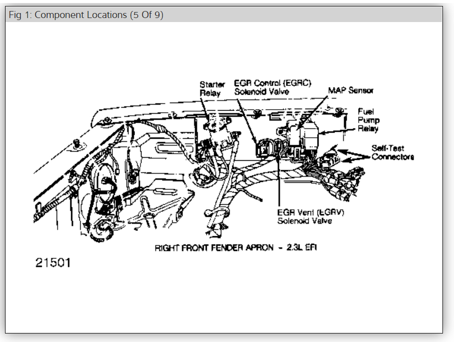

Where is the EGR valve located on the vehicle listed above Bronco 2?

It's up on the intake manifold. It will look like one of these animals in my picture below!
