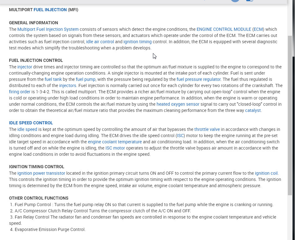

Getting spark and rpm signal from crank sensor. Have the right amount of fuel pressure, got good, compression. Tested pressure regulator with vacuum gauge. Changed MAF no codes. Still wont start.

It keeps fouling them out. Is why I say too much fuel. I got it to start and it was running rough. Took the MAF off and it smoothed out. So I got a new one and put on it same thing. It's still hard to start and runs rough with a spark knock with out the MAF hard start but runs smooth with no spark knock.

Do you have a scan tool that we can monitor the o2 sensor data? We need to see if they are reflecting the rich condition. This could be an injector issue but since it smooths out when the MAF is unplugged shows that it is able to pull the pulse width back and it responds.
Since this is happening, I am thinking the ECM is the issue or it is an input to the ECM so the ECM is reacting improperly and dumping too much fuel.
So at this point we need more info to go on. Hopefully you have a scan tool. If not, we may need to make a guess at it but let's start here. Thanks

I sure do I monitored the o2 sensors and they are both working within parameter thanks.

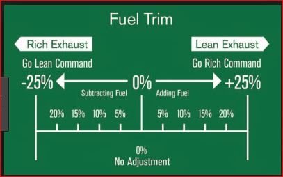

What are the short term fuel trims doing? If this is running rich to foul the plugs they should be negative which means it sees a little amount of oxygen which means there is more fuel in the exhaust, which means it should be commanding the pulse widths to shorten. If the o2's are within spec and the plugs are fouling from fuel then that is an issue.
