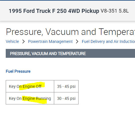

It is a 351 cubic inch engine. As far as the issue, it could be a faulty crankshaft position sensor. Do me a favor. Take a look through this link and let me know if it mirrors what you have experienced.
Also, I attached the fuel pressure specifications below if you want to check pressure.
Let me know if you were able to check for codes using the procedure I mentioned above.
Take care and Happy Labor Day.
See pic below.

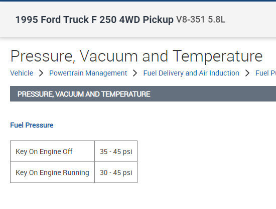

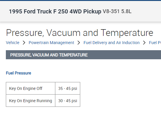

Did is start when you held the fuel pedal to the floor? If it did, I would suggest starting by checking the fuel pressure. I attached a how to link above. The fuel Schrader valve is on the fuel rail to check pressure. Also, there is a fuel pressure regulator on the fuel rail as well. It will have an engine vacuum hose to it. Disconnect the hose and confirm there is no fuel in it.
Next, if the vacuum hose is dry, reconnect it and check pressure. You will need a pressure gauge, but most parts stores will lend one to you. I also attached the manufacturer's fuel pressure specifications below.
Try this and let me know the results. Also, let me know if you tried retrieving codes using the link I included above.
See pic below.
