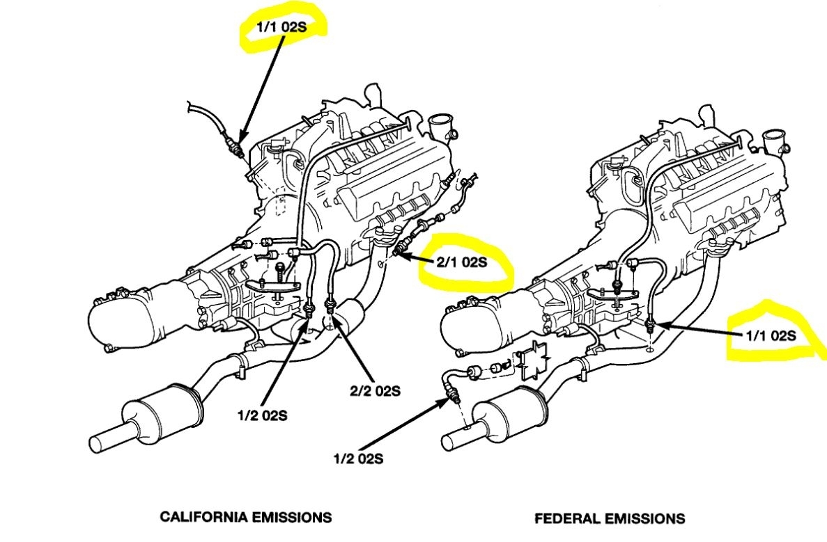

My husband was driving the vehicle the other day, all of a sudden it stalled. He got it started and the check engine light was flashing, he turned around and drove it about 10 miles home. Code reader said misfire #1 and #2. So he changed all 8 plugs and all 8 coil on plugs. He started it up and running really rough. Plus there is white smoke (that stinks) coming out from under front end. Please help, we just put $3,000.00 into on tires, front end parts, driveshaft, misc. other things. Please help.

From the description I would think one of two things. The first is that the misfires loaded the exhaust with raw fuel. That could cause the rough running as it's trying to burn that off and causing the fuel mix to go crazy as it tries. Second would be if the raw fuel overheated the catalytic converter enough that it fused the substrate and it's blocking the exhaust flow, that would cause rough running and the smell.
As a test I would remove the front O2 sensors and start it, if it runs better then you will need to check the exhaust system for blockage.
This shows a few tests that could help:
Does it also have white smoke out of the tailpipe? Or if you hold your hand over the exhaust is any coming out?
The sensors can be different on that truck depending on which emissions system it has. The federal version has 2 sensors while the California version has 4, the ones to remove will be the first ones in the pipes coming from the exhaust manifolds. Those are also the ones you test in.

The muffler and back tailpipe came apart, right where the hanger is. Also I hear like a whining noise under the hood. Husband doesn't here it. We had a small oil leak, it now seems a little worse. Also when he took the plugs out, there were a few that looked white, if that makes any sense.

Doing the exhaust pressure test and seeing what the engine does with the sensors out. I would say to drop the exhaust off the manifolds but if they have never been touched they might break instead of come loose.
