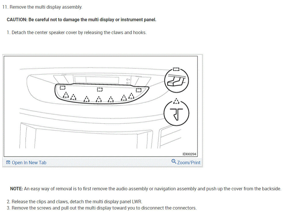

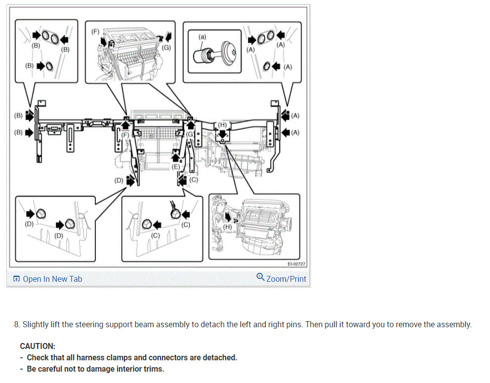

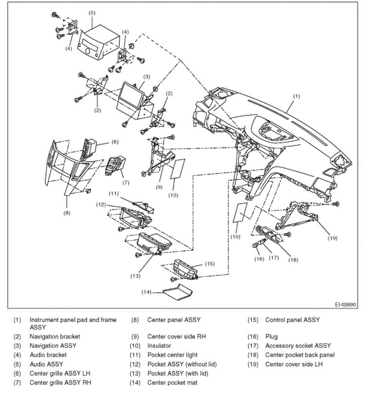

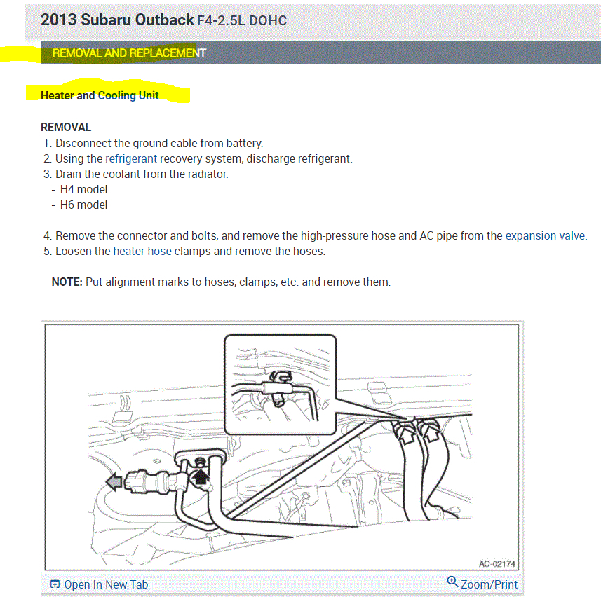

While installing a new mode selector actuator, one of the plastic arms for one of the flapper doors broke flush. Local repair shop wants $2,000.00 to fix, because entire heater core box has to be replaced $900.00 from Subaru (Subaru doesn't sell a repair kit or just the door). Was quoted 11 hours of labor, because the dash has to be pulled off. I would like to attempt this repair myself.
My question is, if I can find just the flapper door, is it possible to replace just the door without removing the entire heater core box (once removing the dash)?

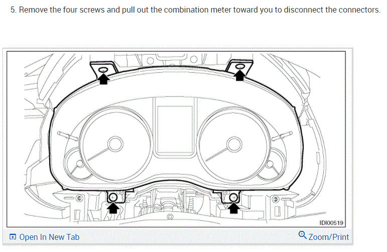

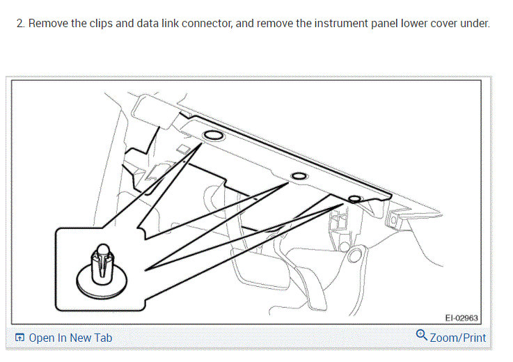

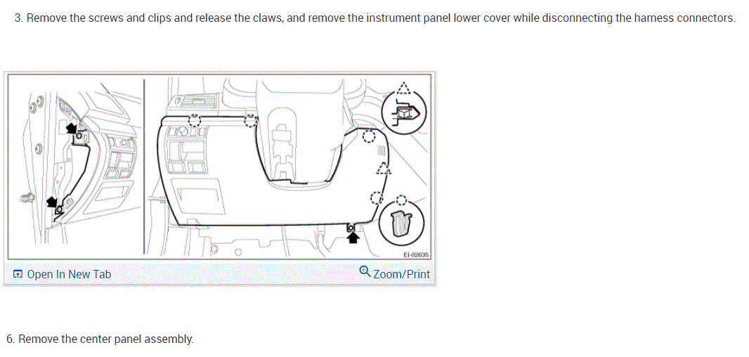

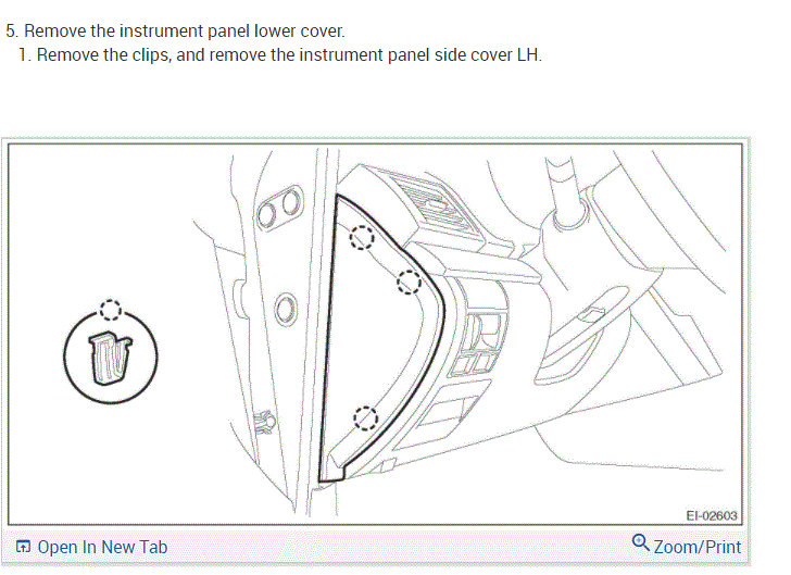

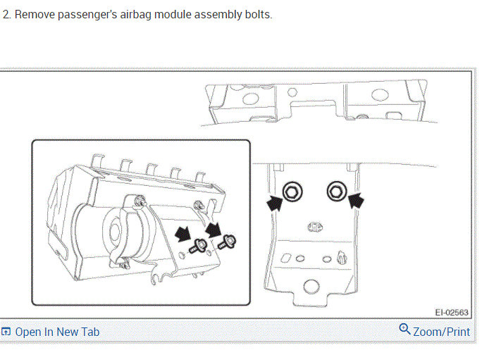

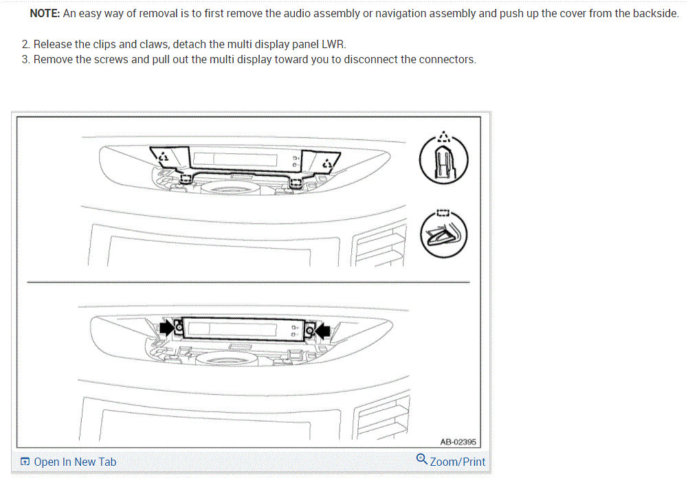

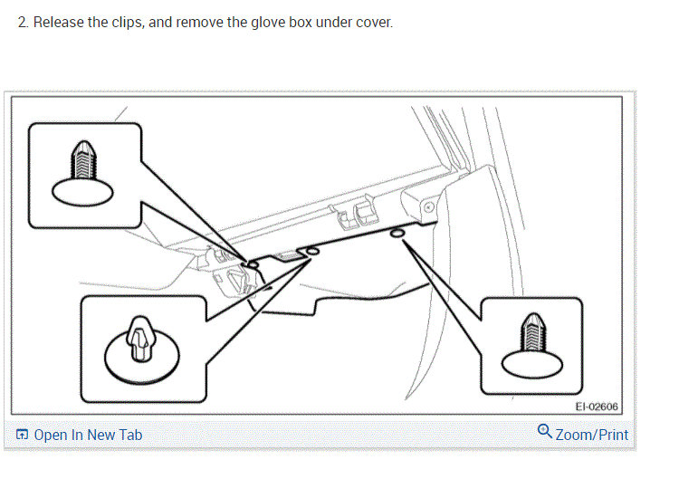

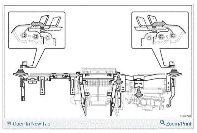

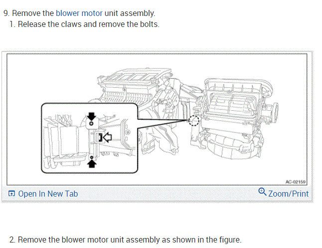

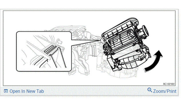

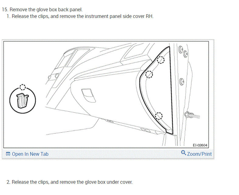

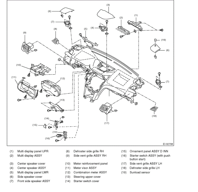

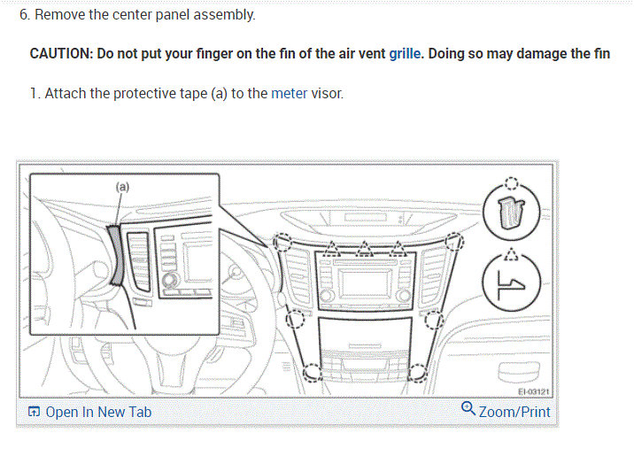

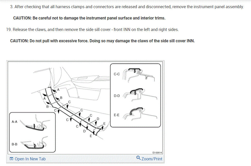

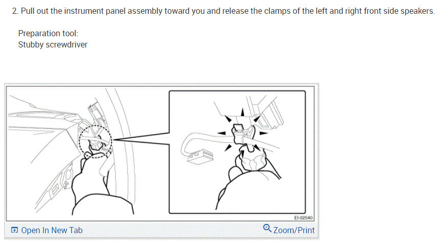

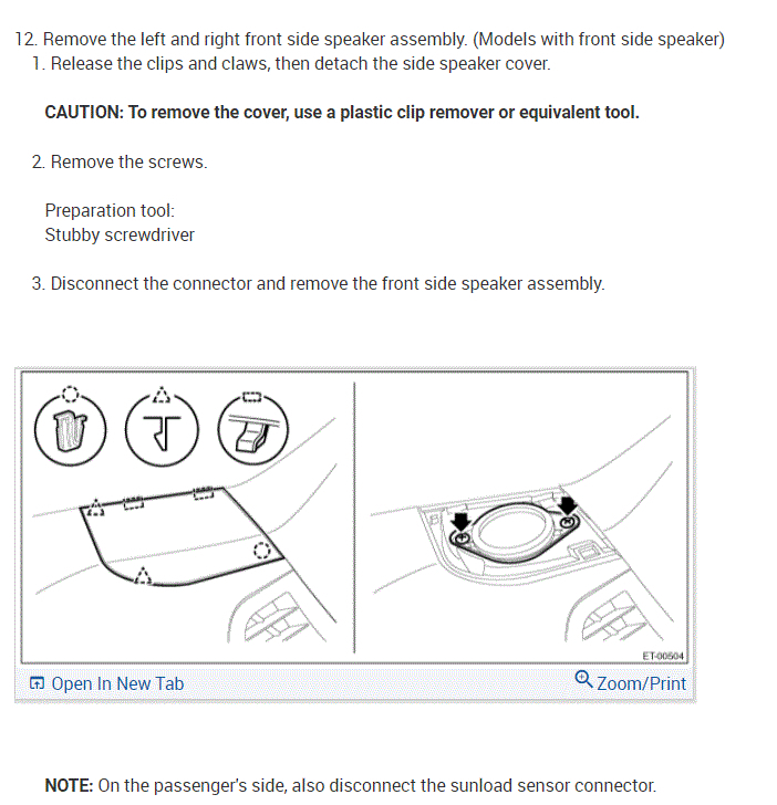

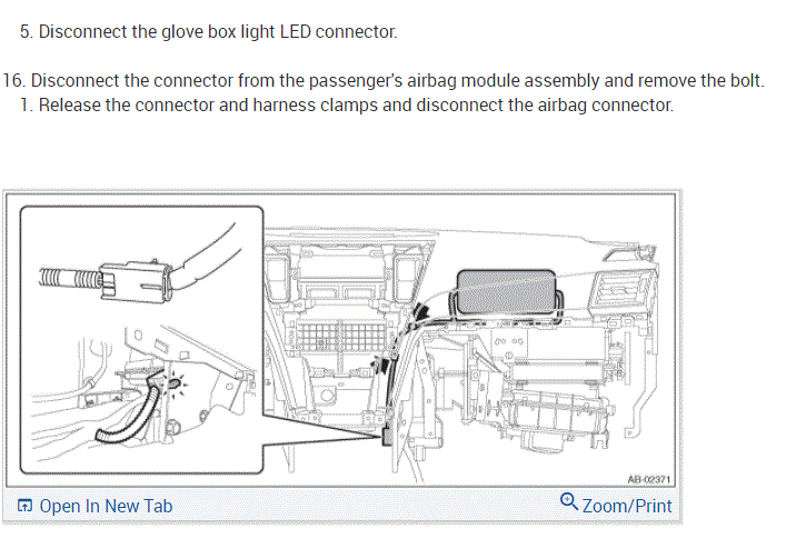

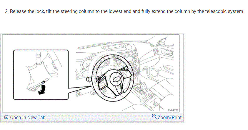

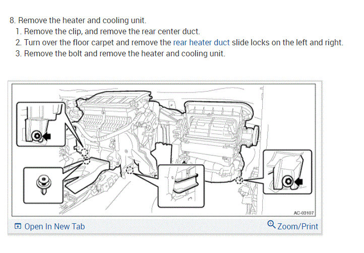

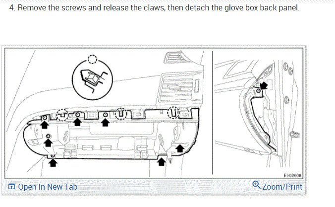

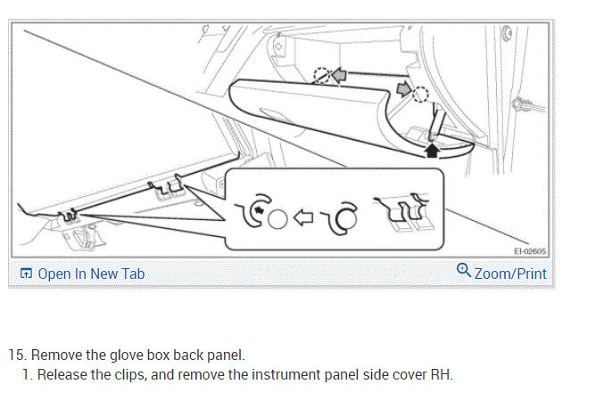

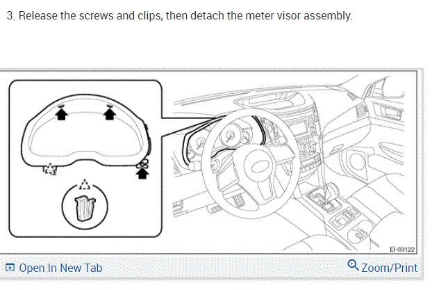

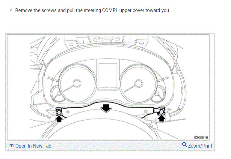

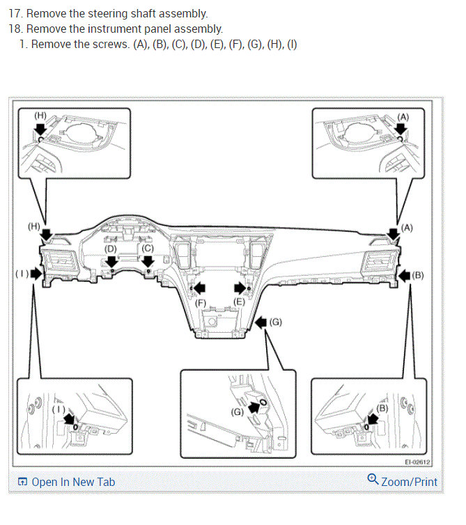

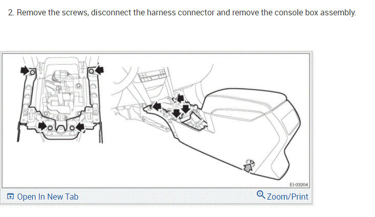

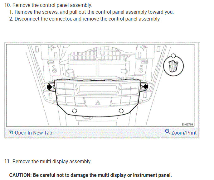

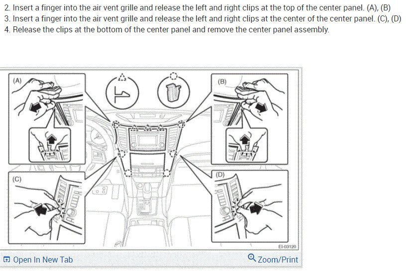

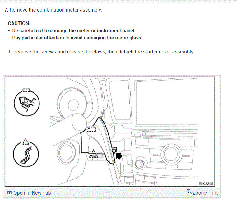

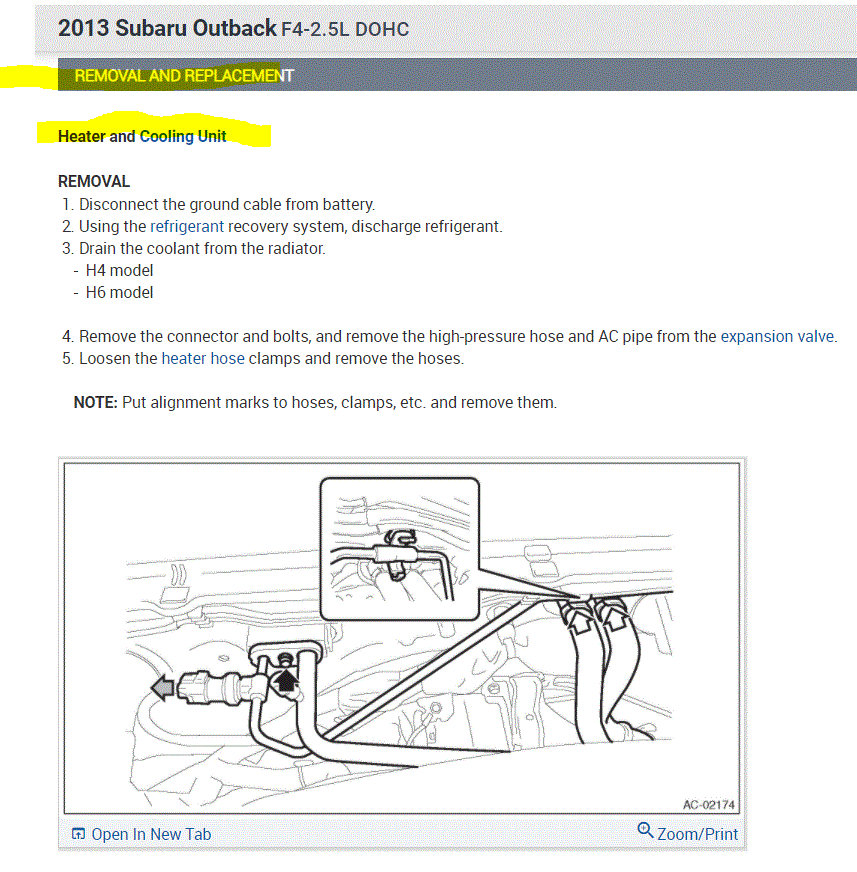

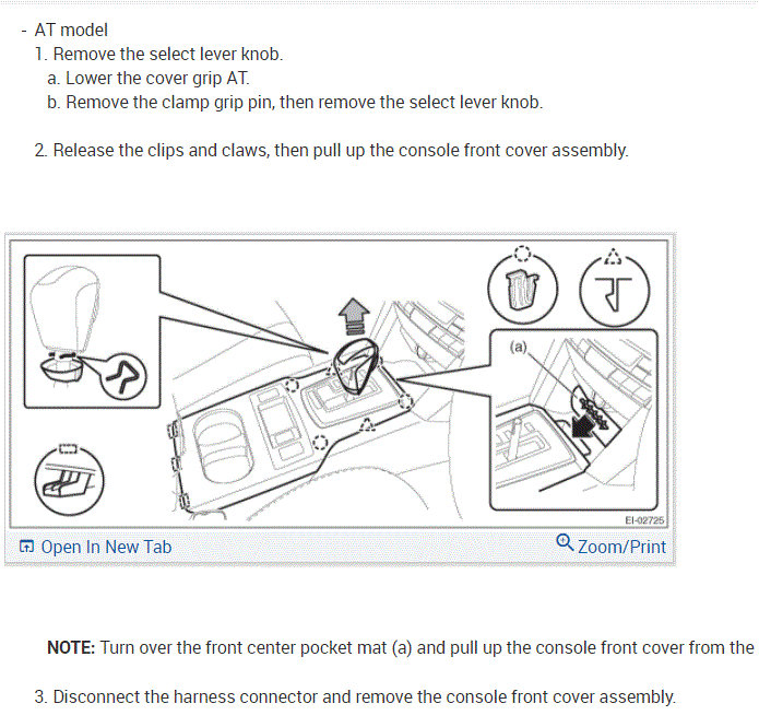

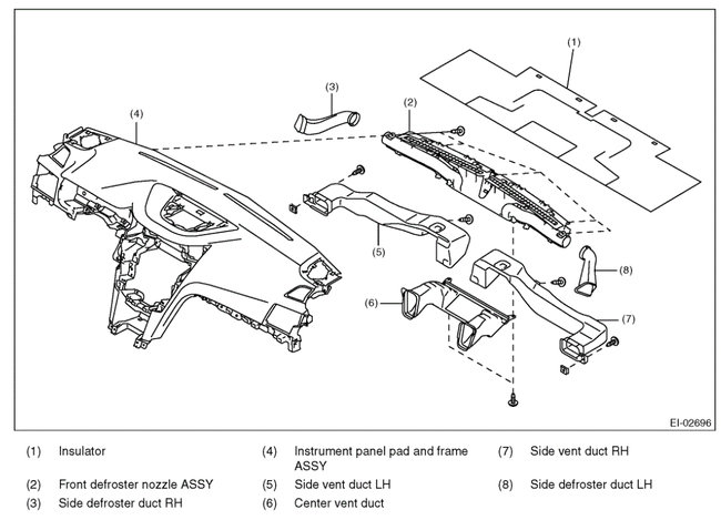

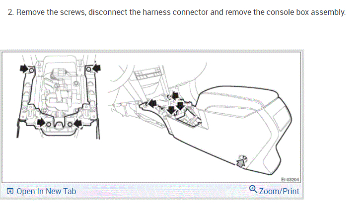

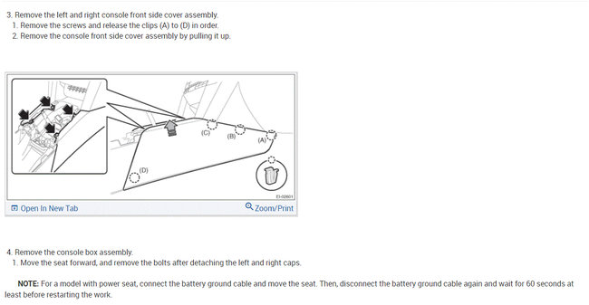

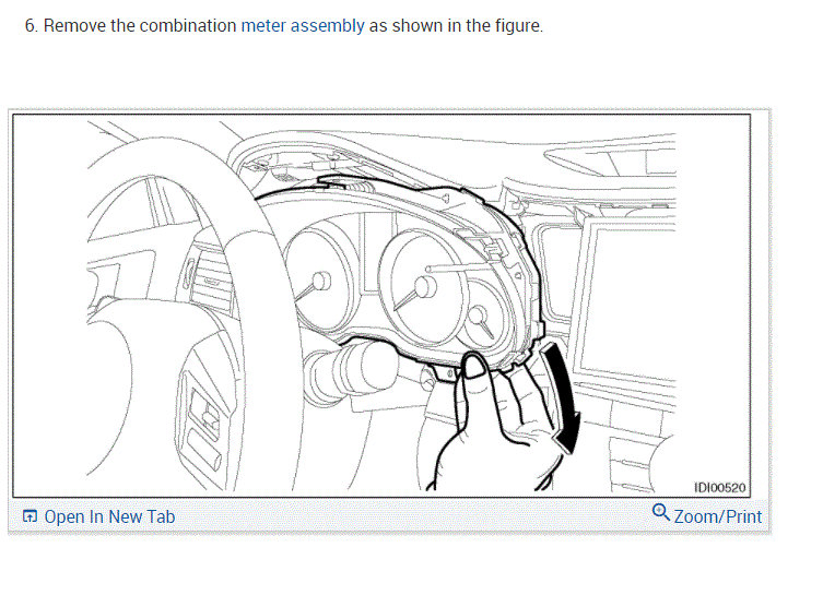

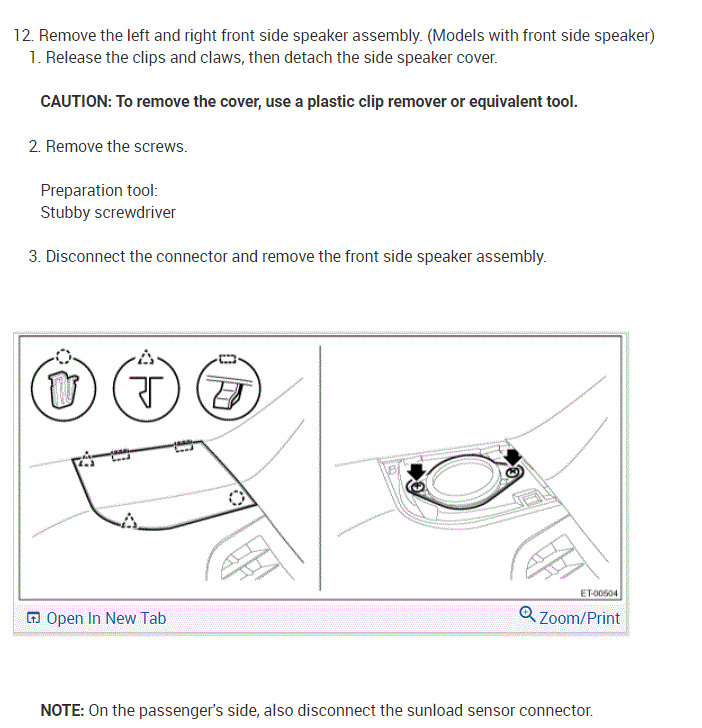

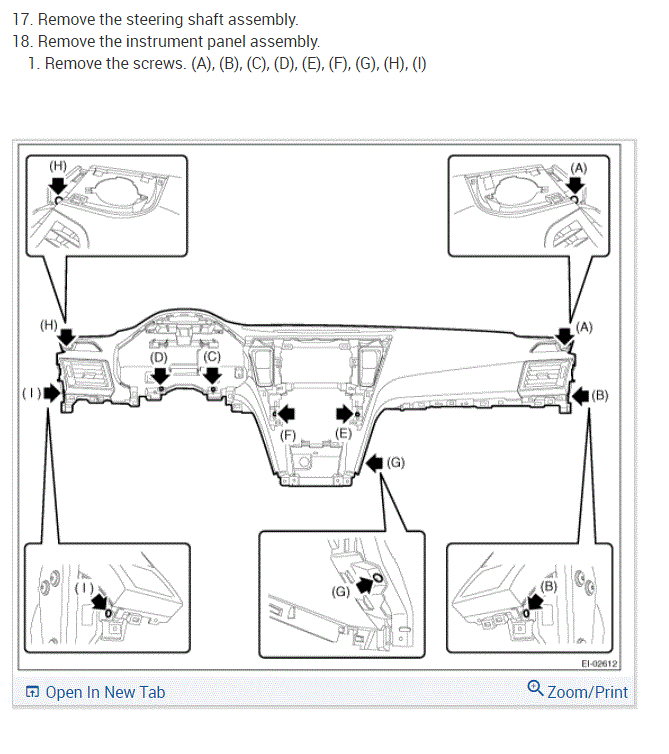

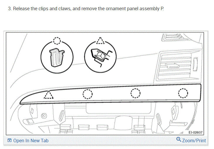

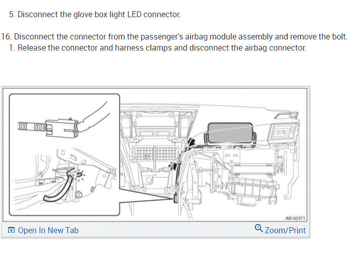

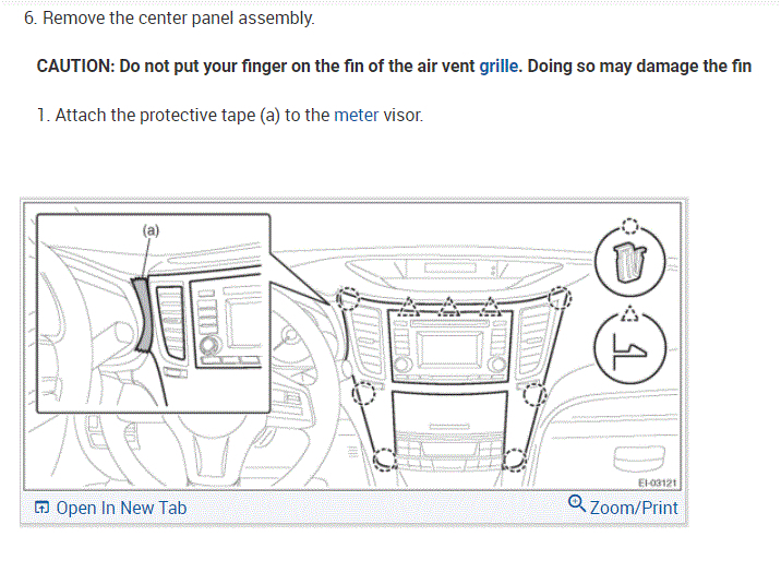

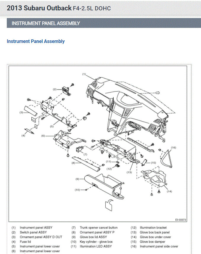

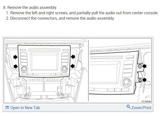

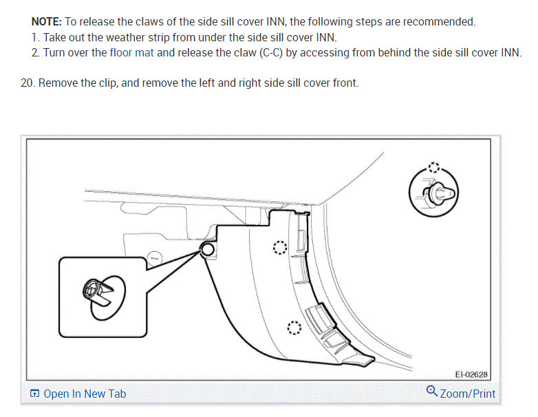

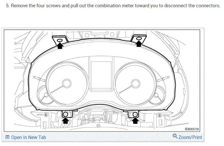

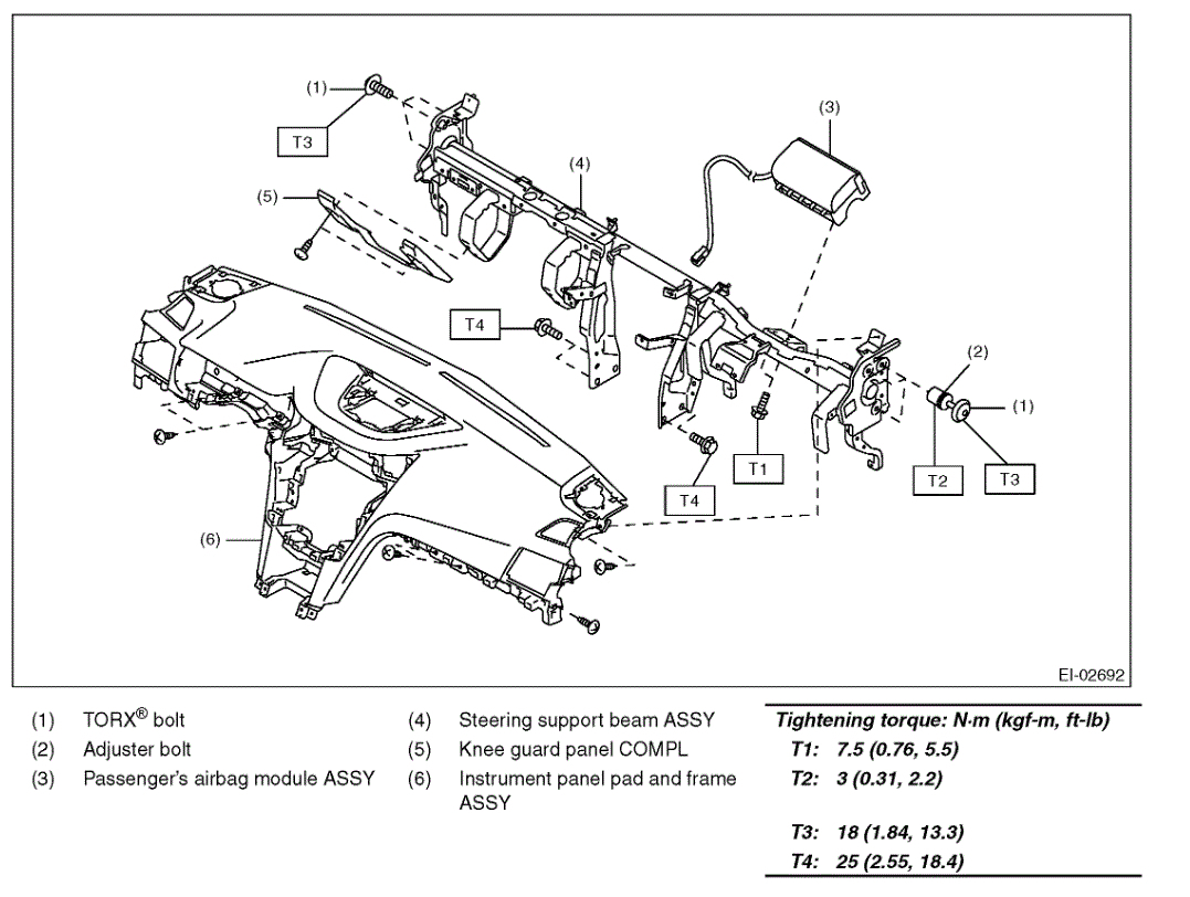

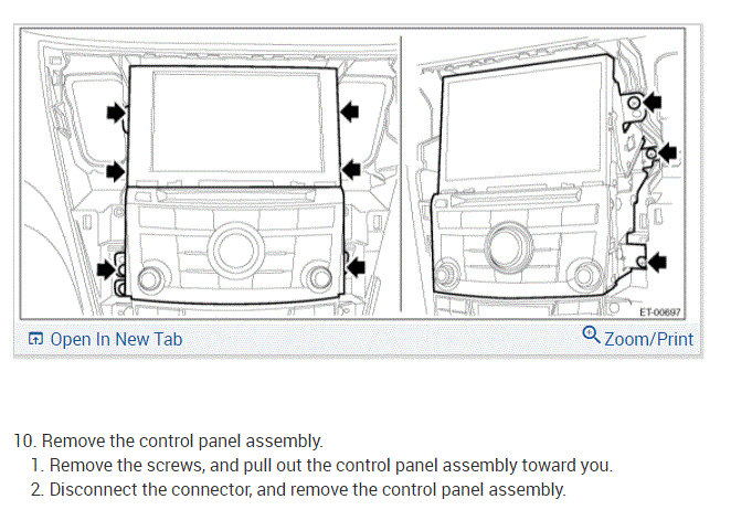

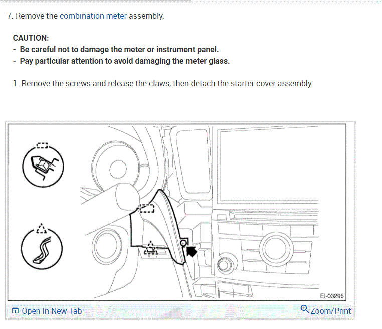

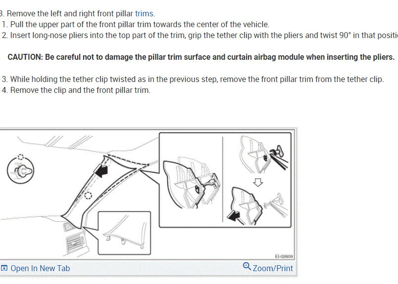

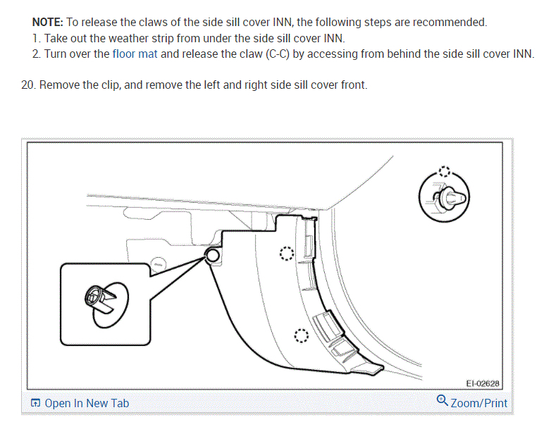

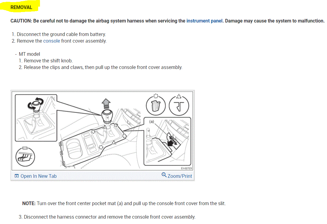

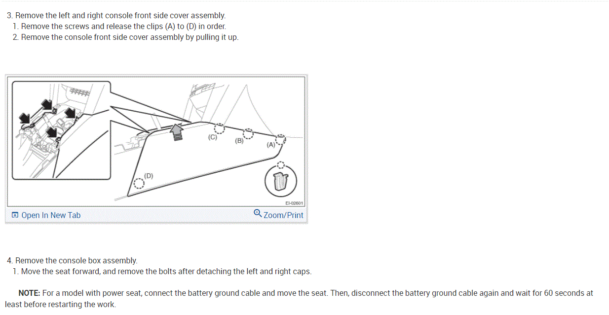

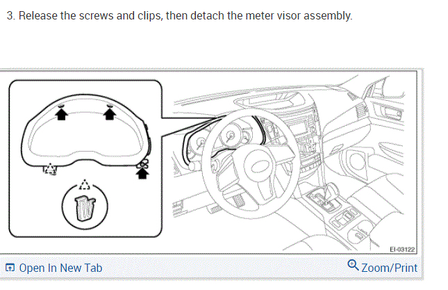

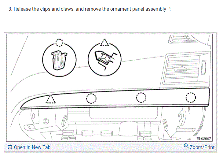

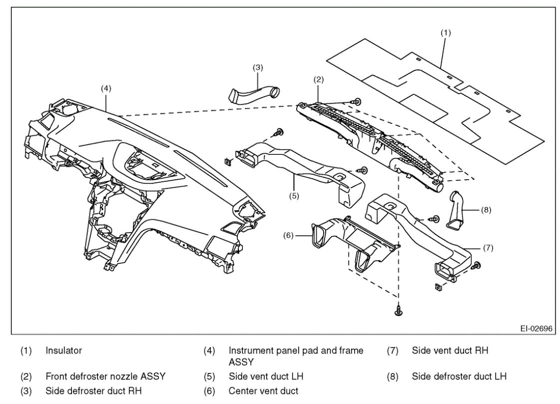

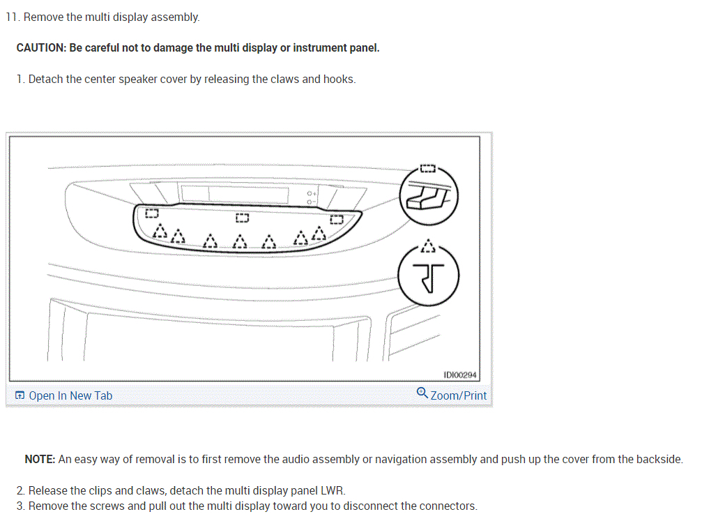

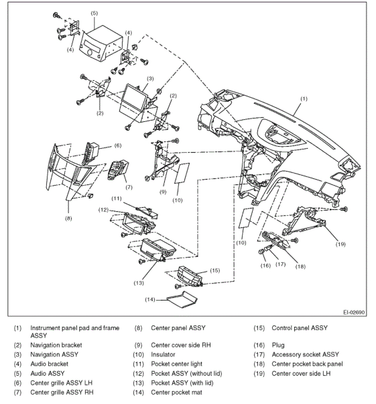

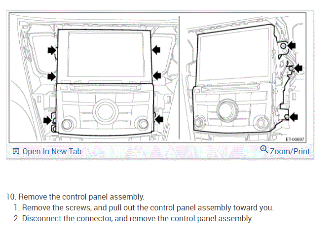

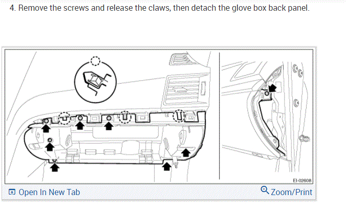

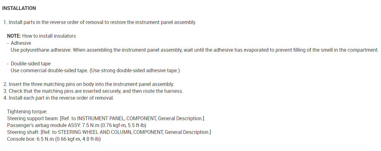

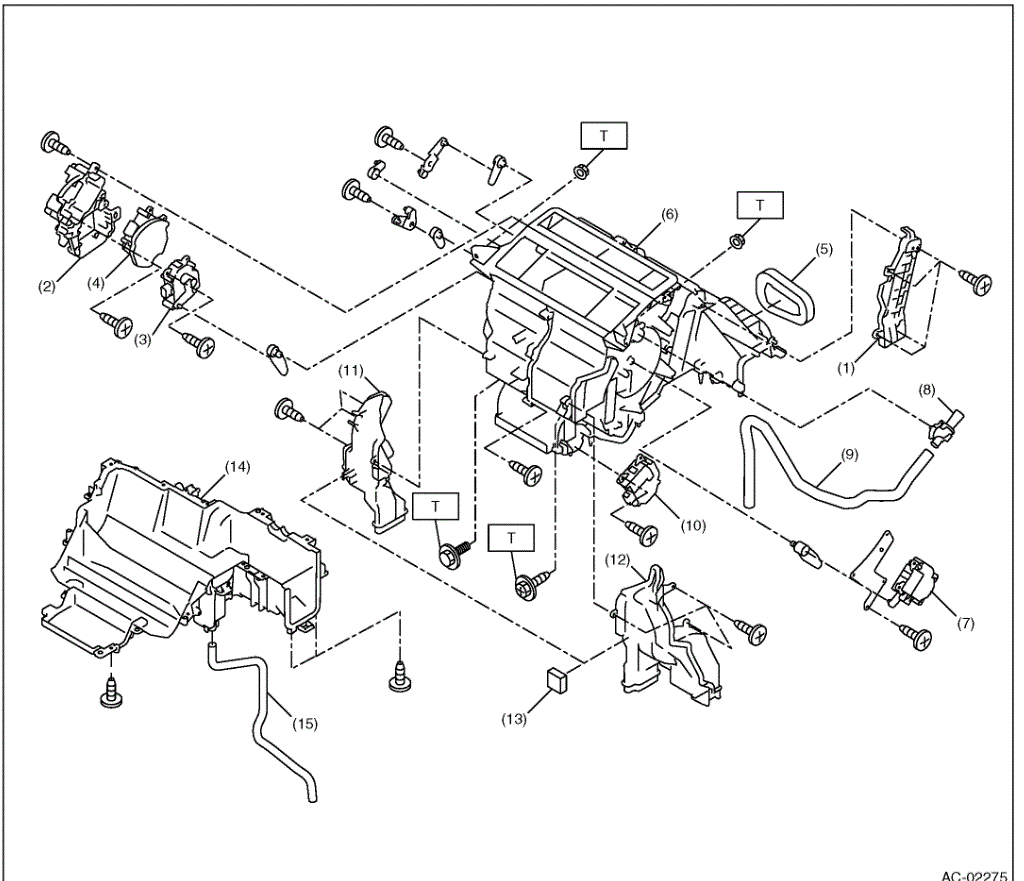

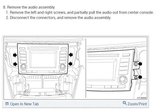

Chances are you won't be able to replace it without the removal of the components. The HVAC box needs taken apart.
I attached the directions for the removal of the instrument panel assembly. Note: You will need to drain the engine coolant and recover the freon from the A/C system for this procedure. After that, I included the directions for the heater core case removal.

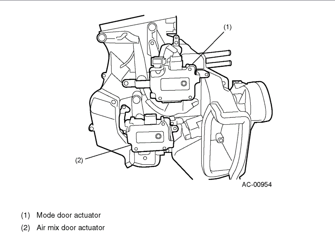

Update: So, there was still some of the flapper arm sticking out of the hole, so I tried gluing the rest of the arm to it using Loctite brand plastic adhesive. It appears to have glued, and I will be trying to reinstall the mode actuator soon.

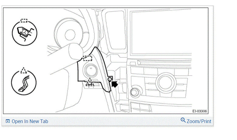

Does anyone have a picture of which groove (cam) on the actuator do each of the three flapper arms go into? I don't want it to break it again! As I think I put it in wrong the first time, and that is why it broke.
Saturday, October 23rd, 2021 AT 9:38 AM
  • 110,194 POSTS
Let's hope it holds. As far as the linkage, I found two pics that may or may not help. Pic 2 is likely easier to follow.
Let me know if this helps.
