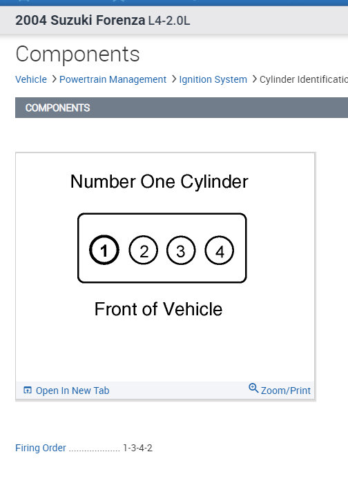

What is the firing order for this vehicle?
CHEST0722
  • 2004 SUZUKI FORENZA
  • 2.0L
  • 4 CYL
  • 2WD
  • 200,000 MILES
Backfiring, bad pick up.

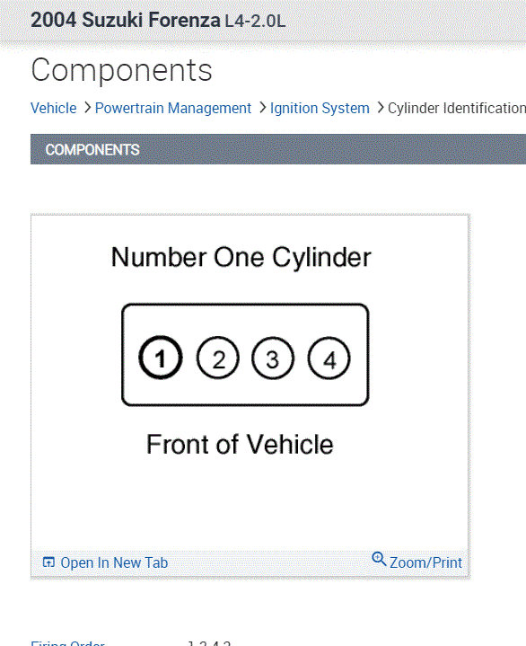

If you look at pic 1, it provides the firing order. Pic 2 shows the cylinder orientation.
If you haven't worked on the ignition system, the firing order shouldn't have changed. Oftentimes, a backfire is caused by either a lean or rich fuel mixture. Do you notice any black smoke from the exhaust?

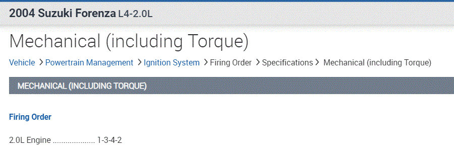

I need the firing order please. The plugs were put on by the length of the wire for 2004 Suzuki Forenza. If got throttle body going crazy. Please give me the firing order only.

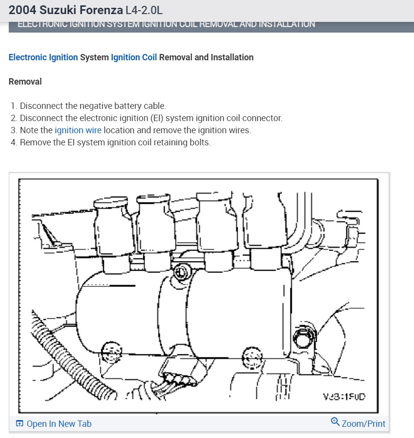

It should have numbers on the ignition coil to match up to the firing order, here is a diagram for you to look at the number should be in this area. Check out the diagrams (below). Let us know what happens and please upload pictures or videos of the problem.

Need firing order, the wire was put on using the length of the wire, mistake. What is the firing order? The throttle is going crazy.

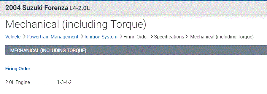

The firing order for this engine is 1-3-4-2.
The number 1 cylinder is the one on the left side (if you are facing the engine).
See diagram below for reference.
Let me know of any questions.
