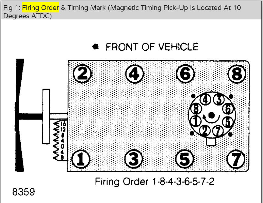

Would like to see a image of rotor pointer position to cap on 1987 Chevrolet 350 TBI. For TDC on number one.

See picture. Should be at about 11:30 with number one at TDC.
