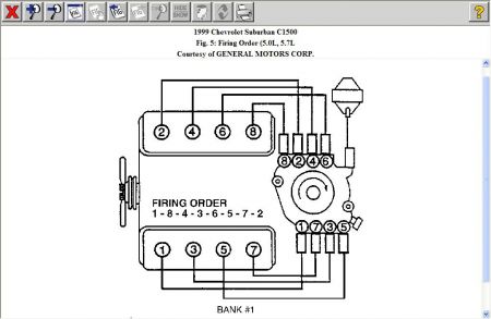

I need the spark plug firing order for my suburban. It is a 7.4 engine.
Friday, June 6th, 2008 AT 10:45 PM
7 Replies
  • 75,992 POSTS
7.4/454CID
https://www.2carpros.com/forum/automotive_pictures/12900_fo_9.jpg

Thank you for the info on the fireing order on my 99 subruban. The check engine light came on and when I checked it it gave me a code of #6 cylinder missfire,
I cleard code and it ran for 20 or 30 mls, and it came on again, so I'm checking the wires and spark plug,
if that dosent do, ware do I go from there?

Next would be to inspect vacuum hoses for damaged or loose connections. Check throttle body and intake manifold for vacuum leaks. Also the PCV valve operation and vacuum lines. A compression check and leak down test on the cylinder will be needed if you still haven't found a fault.

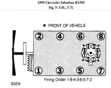

How do you correct the firing order for spark plug wires?
Wednesday, December 4th, 2019 AT 8:57 PM (Merged)
THIS IS MIKE
  • 686 POSTS
Chevy Surburban 1500
https://www.2carpros.com/forum/automotive_pictures/46392_firing_order_chevy_suburban_1.jpg
Firing order

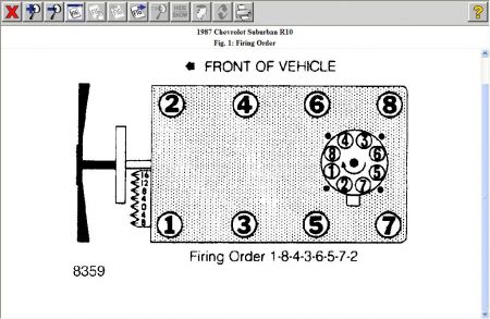

I need to know the firing order for a 1987 suburban with a 350. And also the order they go on the cap. Thanks alot
-1
  • 75,992 POSTS
Here you go, Sir
https://www.2carpros.com/forum/automotive_pictures/12900_fo1_4.jpg
