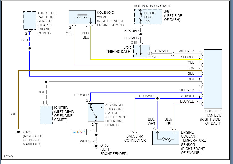

So when I turn my car on the fans run but very slow. Is this the way it supposed to be until it warms up or is this a malfunction? I put new relays and it did not change anything. Please help.

I doubt this is a relay or electrical issue, but we should check voltage coming out of the fan ECU just to check and make sure it is being commanded on high when it is supposed to be.
However, if the fan starts spinning as soon as the engine starts and does not speed up then I suspect the fan has failed.

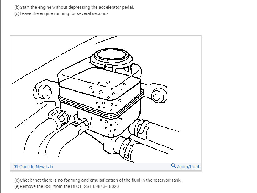

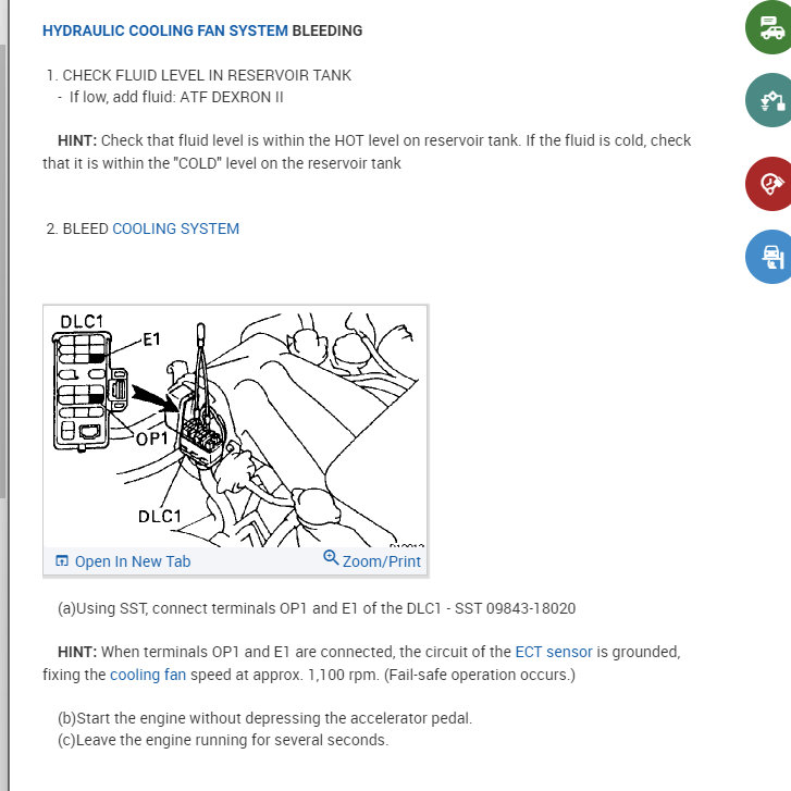

I am attaching the info below on this fan including the bleed procedure to see if this restores normal operation or even improves it.
Please run through this info and let us know what you find. Thanks
