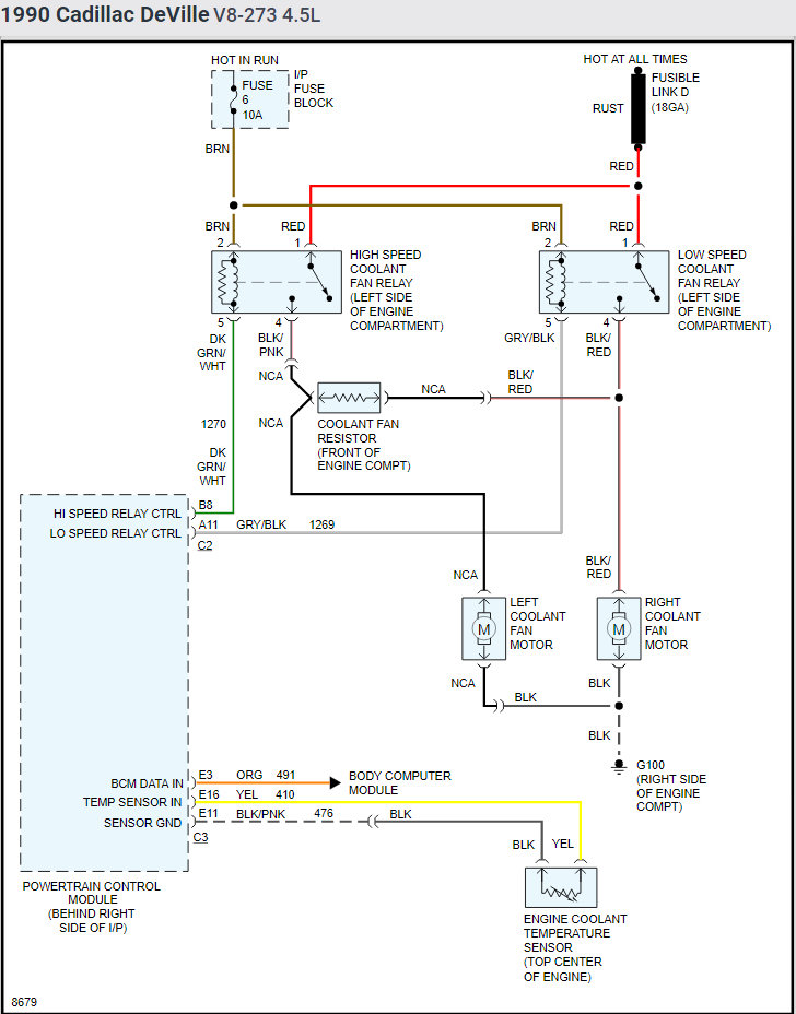

No power to cooling fans.

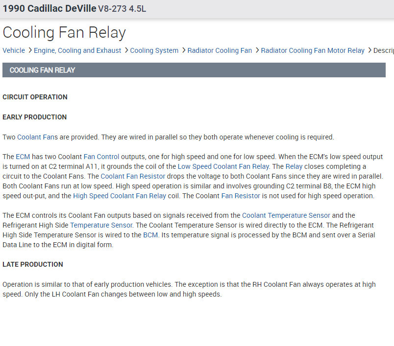

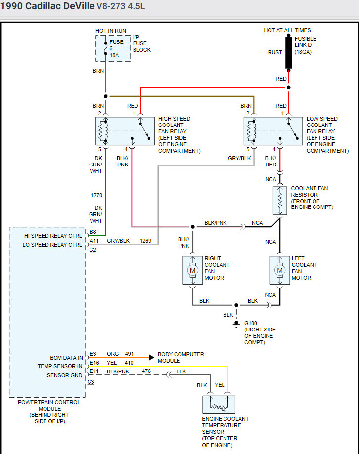

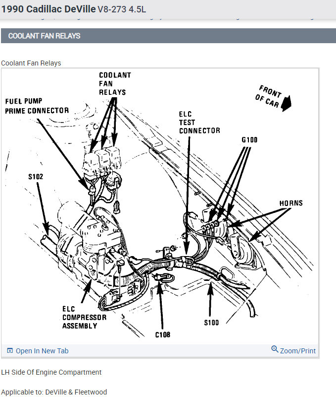

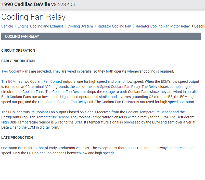

If you are not getting any power to the fan, then the first item needs to be checked is the relay for the cooling fan motor.
That relay is located on the left hand side of the engine compartment (see diagram below).
Inspect the relay for any corrosion or burnt pin(s).
You can also test the relay:
If the relay is good. Then it could be a wiring issue.
I have included the wiring schematics for your reference.

Okay. What part of the info above does not match your car? This info that he attached below his initial response (the location diagrams and wiring diagrams) are all for a 1990 Deville.
What about your car is different concerning the fans? If someone altered your vehicle from R12 to R134a, did they change anything with your fans?
They should not have done anything with this to retrofit the A/C system so I doubt it is related. Which means we need to know what is different about your vehicle from the info provided above so we know what direction to go.
Without knowing how your vehicle is different we are not going to be able to assist as we only have the info in the manuals for this vehicle.
If you look at the wiring diagrams above, there was an early and late production. SQM attached both. There is not much difference between them, but we need to remove the relays and find out if we have power on pin 1 and 2 for each one.
Then jump the relays from pin 1 to 4 and see if the fan comes on.
Let us know about this and we can take the next step. Thanks
