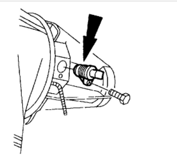

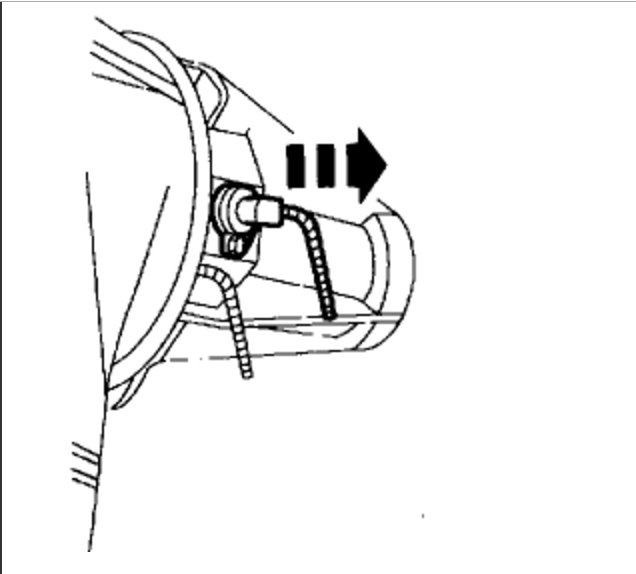

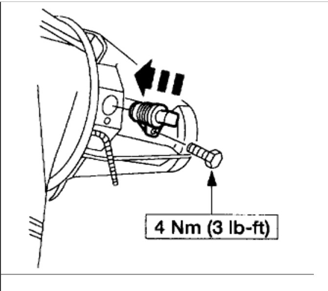

My main concern is the speedometer not working which will cause all of the problem listed above. Start by replacing the vehicle speeds sensor (VSS) which is located at the rear of the transfer case.
Here is a diagram to help you see what I am talking about (below):
