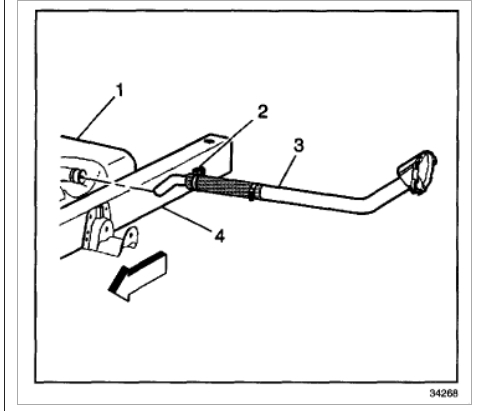

Hi and thanks for using 2CarPros.com. First, it sounds like you have already done a lot and have eliminated many possible problems. The fuel pressure you indicated is correct, so that is not the problem. Since the problem seems to be under a load, the fuel pressure is correct, and the engine is properly tuned, that makes me question back pressure in the exhaust. My first questions is the catalytic converter being partially plugged.
Here is a video related to checking a catalytic converter:
https://youtu.be/kNXh1Lphzr4
Here is a list of symptoms:
General directions:
https://www.2carpros.com/articles/catalytic-converter-replacement

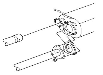

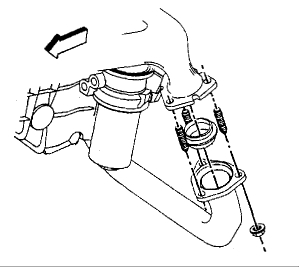

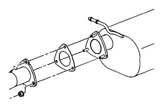

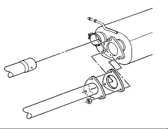

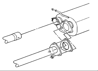

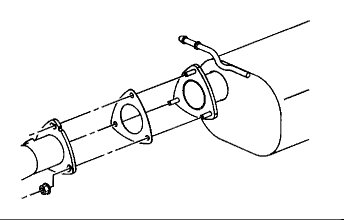

If you determine the converter is a problem, the following are the directions for removal and replacement specific to your vehicle. I have also attached pictures to help guide you.

Remove the nuts and the seals retaining the catalytic converter pipes to the exhaust manifolds.
If equipped with single catalytic converter pipe, remove the nuts retaining the catalytic pipe to the muffler. Depending on the vehicle configuration the flange may be a 2 bolt or 3 bolt flange.
Remove the catalytic converter pipe flange gasket.
Remove the catalytic converter pipe from the vehicle.
If equipped with 2 catalytic converter pipes, loosen the clamp securing the right catalytic converter at the front of the muffler.
Remove the right catalytic converter pipe from the muffler and the vehicle.
Remove the left catalytic converter pipe retaining nuts and gasket from the muffler flange connection.
Remove the left catalytic converter pipe from the vehicle.

If equipped with 2 catalytic converter pipes, install the left catalytic converter and gasket to the muffler flange.
Install the nuts for left catalytic converter to muffler. Do not tighten the flange nuts.
Install the right catalytic converter into the muffler.
Install the right catalytic converter clamp. Do not tighten the clamp.
If equipped with a single catalytic converter pipe, install the pipe with a new gasket to the muffler flange. Do not tighten the flange nuts.
Install a new seal and the catalytic converter pipe to the exhaust manifolds.
Notice: Refer to Fastener Notice in Service Precautions.
Install the nuts retaining the catalytic converter pipes to the exhaust manifolds.
Tighten the catalytic converter pipe to exhaust manifold nuts to 65 Nm (48 ft. lbs.) .
Verify that the exhaust system is properly aligned and tighten the right catalytic converter clamp to 54 Nm (40 ft. lbs.) .
Tighten the catalytic converter to the muffler nuts to 48 Nm (35 ft. lbs.) .

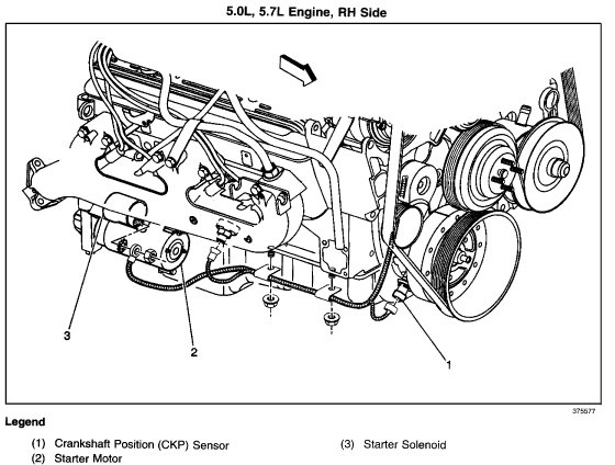

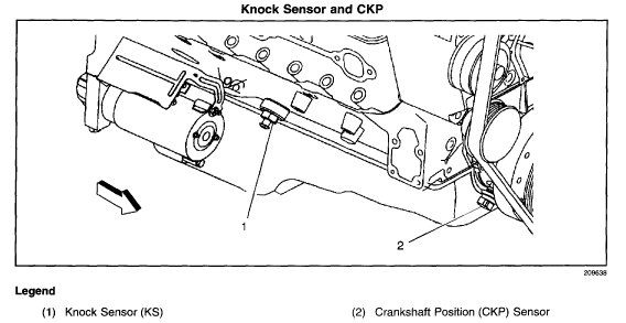

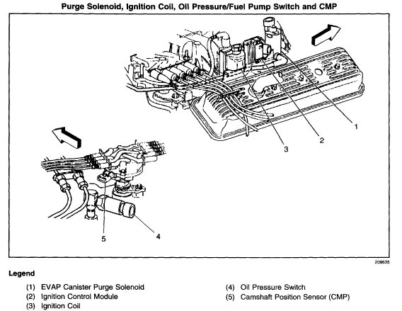

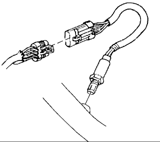

Interesting. I thought that may be the issue. If fuel pressure is good, it us tuned properly, and there is no check engine light coming on, That leads me to ignition timing. I realize the ignition timing is not adjustable and is controlled by the PCM, but I question if it is doing its job. If you have a live time scanner, drive the vehicle and watch ignition timing to make sure it is advancing. Keep in mind, the crankshaft and camshaft sensors play a big role in ignition timing and fuel delivery. Everything you have told me leads me to believe it is a fuel related issue, but everything checks good.
I have attached pictures of both sensors and locations. I am starting to question if the pump, even though checks good when tested, cannot keep up with the demand under a load. When you replaced it, it ran good for a short time. I am going to ask the owner of the site for his opinion. Maybe he has a different idea.
Expect a reply from him. I am going to send him this link.

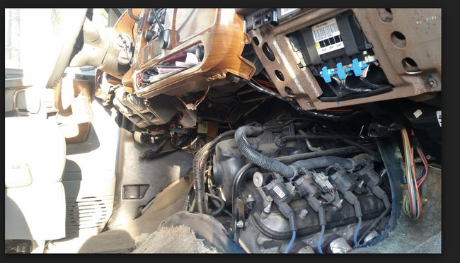

Can I ask you say ignition rotor but this engine does not have one? Is there a different engine in this van?
-1
Sunday, May 13th, 2018 AT 11:09 AM
JIMMYCASS64
  • 9 POSTS
Hi Ken, if this question is addressed to me, I am confused. The only mention of rotor I have written is the one under the distributor cap. Engine is 5.7l vortec.
Sunday, May 13th, 2018 AT 2:51 PM
KEN L
  • MASTER CERTIFIED MECHANIC
  • 55,069 POSTS
Here is a picture of the engine in a 2001 Chevrolet van no distributor. I just want to make sure we are working on the right engine.
+1
Monday, May 14th, 2018 AT 9:47 AM
JIMMYCASS64
  • 9 POSTS
Now I understand. Definitely different. I had to remove my front tires to change my spark plugs. I met with a mechanic this morning, and he suggested I do another fuel pressure test, and this time while driving. I did. Key on 58 psi, idle 50 psi. Accelerating up hill 54psi, dropping to 52, then 50 once I was off gas. Steep hill 54 dropping to 53, and again 50 off gas pedal. Level terrain, hard gas from 10mph, baseline 50psi up to 52, dropping to 49, then 50 off gas.
Hoping this makes some sense. Jim

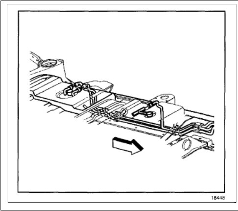

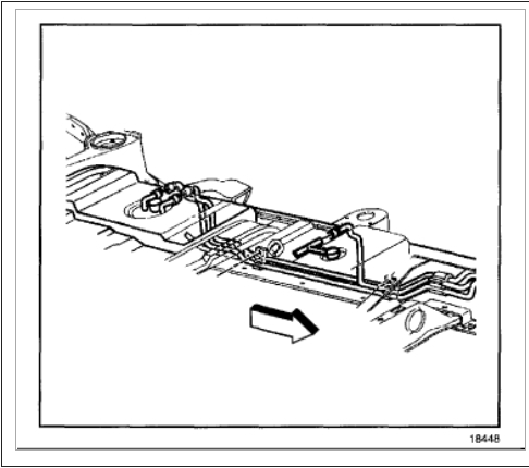

  • 55,069 POSTS

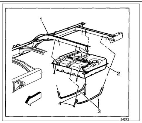

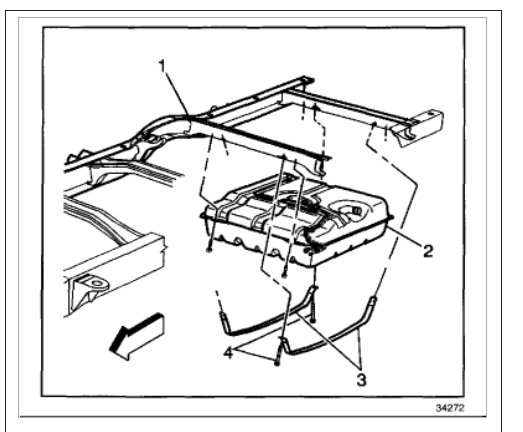

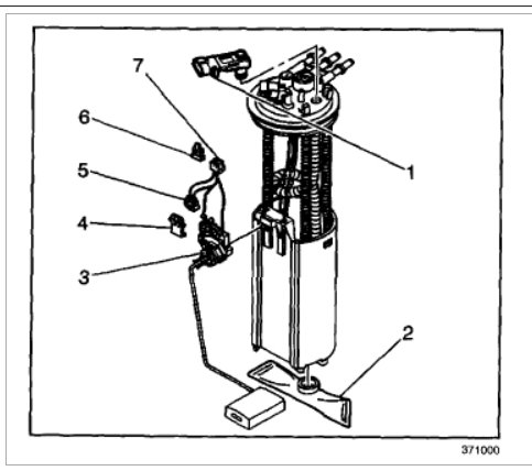

Yes, it sounds like the pump is fading under load. It should be at 55 - 60 psi. Does the van have 38,000? little premature but not surprising because GM had a problem with the pumps I installed two in my truck 2000 Z71. Here is a guide to help you see what you are in for when doing the job:
https://www.2carpros.com/articles/how-to-replace-an-electric-fuel-pump
Here are diagrams to help you see what it is like on your van.
Cheers, Ken.
Tuesday, May 15th, 2018 AT 11:02 AM

Current pump is aftermarket. Have not replaced relay. I appreciate the diagrams you included. Any chance you could forward the corresponding depicted part names shown?
Wednesday, May 16th, 2018 AT 4:02 AM
KEN L
  • 55,069 POSTS
Here are the instructions:
Disconnect the negative battery cable.
Relieve the fuel system pressure. Refer to Fuel Pressure Relief Procedure.
Drain the fuel tank. Refer to Fuel Tank Draining Procedure.
Remove the fuel tank.
Remove the fuel sender assembly.
Note the position of the fuel strainer (2) on the fuel sender.
Support the fuel sender assembly with one hand, and grasp the strainer with the other hand
Pull the strainer from the fuel sender.
Inspect the strainer. Replace a contaminated strainer and clean the fuel tank. Discard the strainer after inspection.
Disconnect the fuel pump electrical connector (5).
Remove the electrical connector retaining clip (6) from the fuel level sensor.
Disconnect the electrical connector (7) from the fuel level sensor under the fuel sender cover.
Remove the retaining clip (4) from the fuel level sensor.
Squeeze the locking tangs, and remove the fuel level sensor (3).
Remove the fuel pressure sensor (1).
Install the fuel pressure sensor (1).
Install the fuel level sensor (3).
Install the retaining clip (4) to the fuel level sensor.
Connect the electrical connector (7) to the fuel level sensor.
Connect the electrical connector retaining clip (6).
Connect the fuel pump electrical connector (5).
IMPORTANT: When you replace the fuel tank fuel pump module, always install a new fuel strainer
