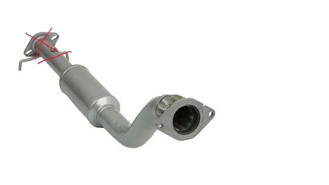

Exhaust broke off at flange behind converter. Flange has been cut off, but there is not enough remaining straight pipe to get a good connection. Is it safe to cut the exhaust between the converter and rear 02 sensor so that we can run a straight pipe to reconnect the rest of the exhaust system? This would leave the converter but eliminate the rear 02 sensor.

If you eliminate the O2 sensor it will set a code, try welding a piece of pipe to the converter or inside it to reconnect.

We do not have a welder handy and are trying to fix in a home garage. I realize that eliminating the sensor will send an error code to the computer, but will it affect the overall operation of the vehicle?

Below I have marked the section that I would like to eliminate from the exhaust system.

It really isn't that expensive to have an exhaust specialty shop do this for you. And then it's done right.

Wrench tech is right.
