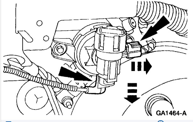

Truck will run for just couple minutes then it’s like it overloads and dies but will not start back till it cools off Evap?

This can be many things, but it sounds like the fuel pump or crankshaft angle sensor is going bad but we should start by scanning for codes. Here is a guide to help
There is a possibility it is the EVAP purge valve so I would remove the vacuum line from it for now to see if it makes a difference.
Here is the location so you can run the test. Please go over this guide and get back to us.
