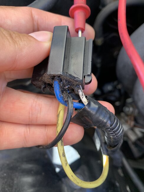

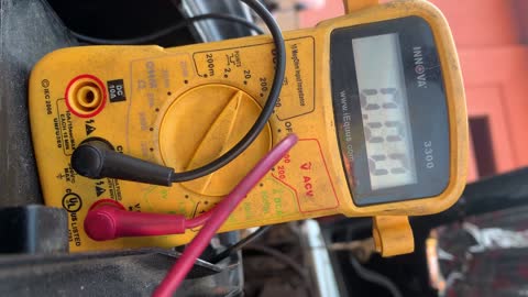

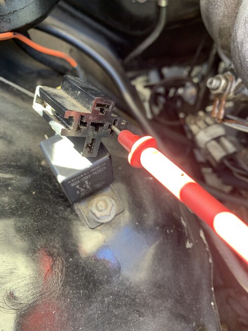

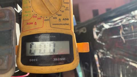

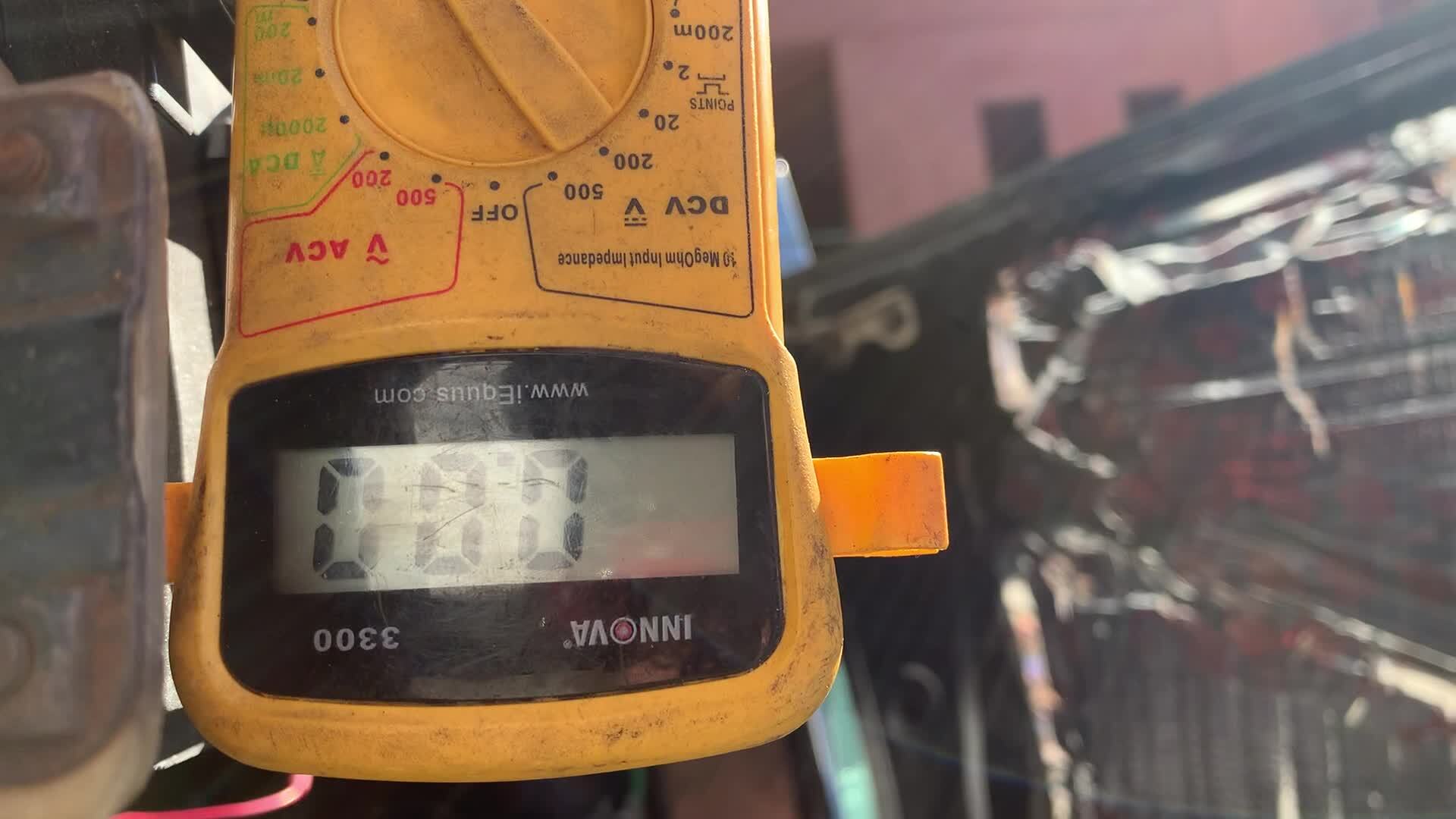

Okay. I tested the trigger wire's connection through my hot shot (pictures included). I wasn't sure which wire (white or blue) was for the trigger wire since they're connected inside of a split loom that I didn't want to risk peeling back/off, so I tested each wire.
The blue one would give a reading of 0.01v when I turned the key to run.
The white wire would get a reading of 11.40v.
The battery has discharged a little, so I put it back on a trickle charger.
Unlike on my previous attempt where the starter would attempt to start then nearly immediately stop, this time I heard no cranking sound whatsoever (just a click) any of the times I tried to start the engine.
The photos are of the hot shot that my starter is wired into - there are additional photos earlier in this message string.
The video is of my turning the key to RUN with the lead on the white wire's location of the hot shot relay.
This relay was installed to bypass the long-distance voltage travels in the original, factory wiring that eventually causes intermittent starting issues solely because not enough voltage makes it to the final location to initialize the starter and/or the contacts wear out and pit. I think I also mentioned this in a previous post on this thread. Happy to explain more if needed.

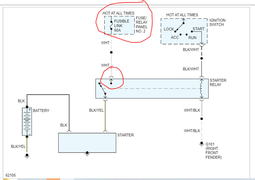

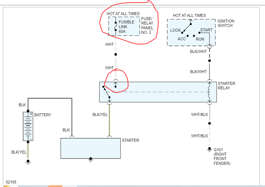

The white wire is the power supply to the secondary side of the starter relay. If the relay is being actuated, power to reach the starter motor's black with a yellow tracer wire when the key is in the start position.
I attached the starter wiring schematic below.
Let me know if that is what you are getting. Note: In the video, the multimeter turns, and I can't see the readings.
See pic below.

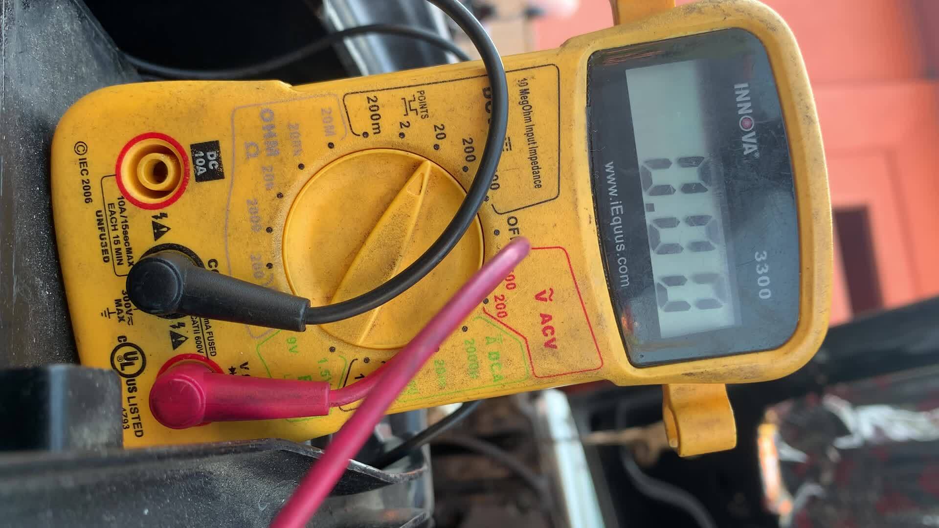

I went out again with a fully charged battery registering 12.63v.
The first try I forgot to hit play on my phone, but I got a 1/4-second-long crank then nothing= no lights, no click, no crank. I tried a few more times and it was more of the same, so I went inside for about an hour then went back out.
The second time I got what you see in the video where I attempt to start the engine three times. After the first three attempts it's back to no lights and no crank and I'm sure if I give it more time and go back out, I'll have lights and at least a click, again.
Q1.) Why the dead response that turns to lights and a click if I wait enough time?
As I'm sure you can see in the video the first two attempts give little voltage change but the third one goes up to 2.44v (with sparks!).

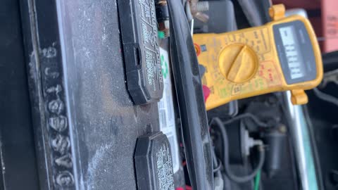

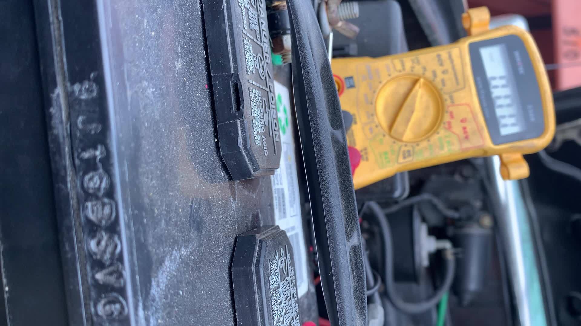

I did a voltage drop test on the negative battery cable. The video shows the results, but it looks like I get the following after each try: 0.81v, 0.84v (with sparks), and 0.73v (no sparks but some smoke). I turned the key three different times, and the truck never went completely dead with the multimeter leads attached. Interesting.
The cable and post on the (-) side was definitely warmer than the (+) side. The cable itself looks completely fine aside from the sparking at the battery post. There are no cracks, bulges, corrosion, etc.
Update: I had a thought regarding the size of the wingnut that holds down the (-) cable on the marine post I've got on the battery. It's small, smaller than the (+) side. I grabbed a washer and put it over the cable then tightened down the wingnut and low and behold, the engine's starter gave me more. I got some gas running through the line and the engine finally cranked over. :)

Update: You were right to begin with. No need to remove the starter - the negative battery cable was hissing and spitting due to too much resistance. My previous post and video showed that. But then, I had a thought regarding the size of the wingnut that holds down the (-) cable on the marine post on the battery. It's small, smaller than the (+) side and doesn't likely create enough surface contact for the cable. I grabbed a washer and put it over the cable then tightened down the wingnut on top it and low and behold, the engine's starter gave me more. I got some gas running through the line and the engine finally cranked over. :)
Hooray! The starter is fine and so are the battery cables.
