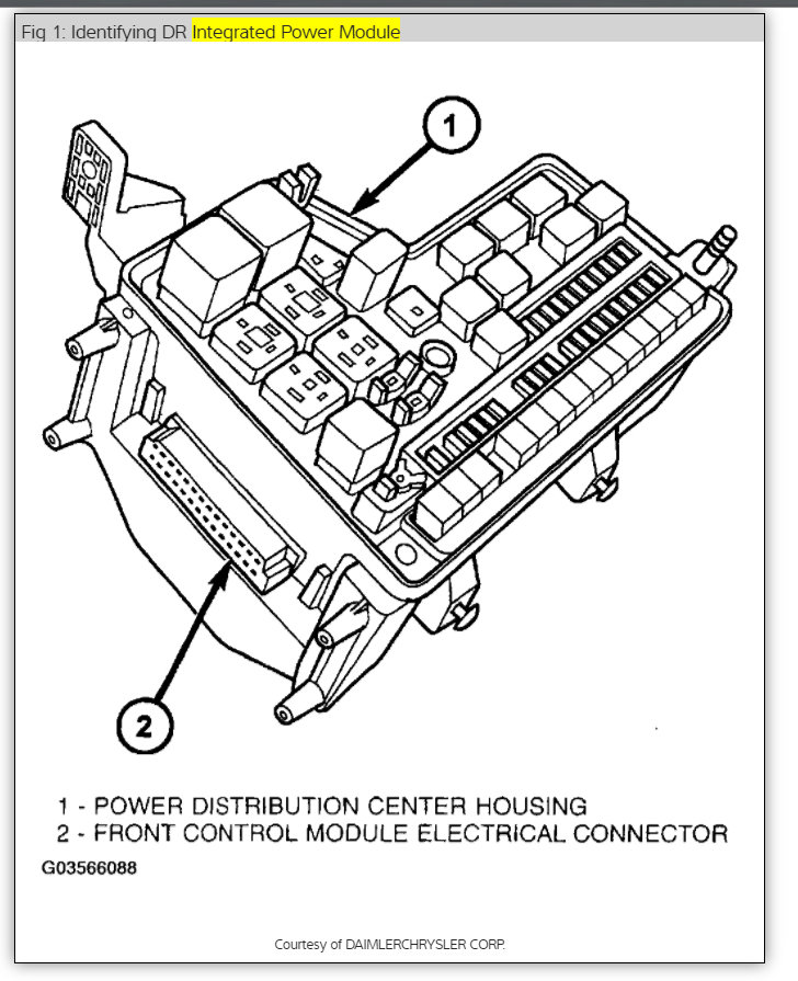

Engine will not crank. It will crank if I bypass the starter relay but will not run with the key in run position. Ignition switch checks good. It is a 45RFE with an internal neutral switch. I do have power at yellow wire with blue stripe at safety switch connection on the transmission with key on. Need some ideas!

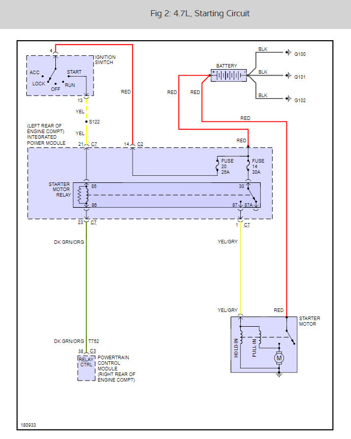

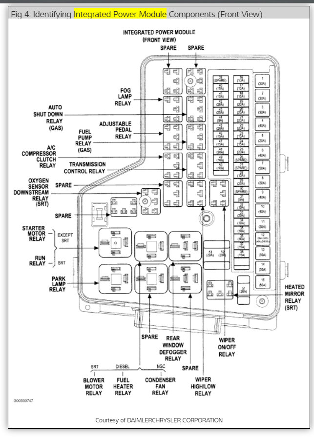

Is the security light flashing when you try to crank it over? If not here is a guide and a diagram to help you test the starter relay and to check for power and ground of the relay:
Below are a few starter wiring diagrams.
Please run this test and get back to us so we can keep helping you.

I have replaced the starter relay previous to asking my question. I have the correct power and ground at all points but the engine still will not crank unless I jump from 87 to 30 and it still will not run with key in run position. Now I am thinking PCM may not be letting signal through. Cannot ever remember seeing security light on, flashing or otherwise.

85 has power? if so then it is the computer not triggering the relay to close. Can you run the codes to see whats come up?
