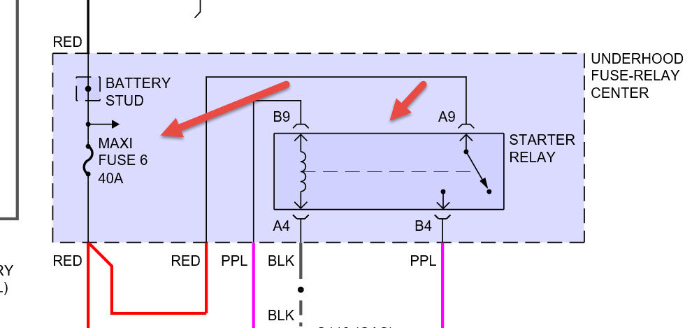

When I turn the key to the cranking position nothing happen the starter want turn the gauges on the instrument cluster don't move no light on in the instrument cluster the turn signal lights not working the head lights are working the hazard flashers are working the bolt that hold the positive cable on the battry the bolt is tight but the cable not very tight how do I tight the cable? The battry have a side post I disconnect the little wire from the starter solenoid and turn the key to cranking position and hook a test light to the starter solenoid small wire my test light light up so current is getting to the starter solenoid, so I bench test the starter motor it will crank what could be the cause for the starter motor not to crank when bolted to the engine?

If you cable isn't tight check to see if the bolt is to long and either get correct one or put a washer behind bolt. Also check items in pic

I put the battry into another truck and it crank the engine I don't it's the battry how do I check the fues and starter relay?

The Maxi Fuse 6 was blown what could couse the fuse to blow and what to check for the cause?

A short will cause the fuse to blow it may have something shorted out it 's for the whole car and just wait and see if it happens again. Also you said your cable wasn't tight that could have done it as well.
